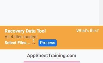

Hi Stefan, thank you for creating this tool. I tried it this weekend but for some reason I can't get the final step to work.
I've successfully uploaded the files, but the "Process" button doesn't become grey and clickable as per step no 7 in your instructions.
Your advice will be much appreciated.
