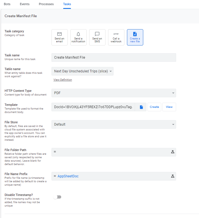

My bot, creates a daily manifest for drivers
It has one process, and that is to create the file:
When I choose to go to the task via the link at the bottom:
I am taken to the task I need (want?) it to run.
Pay attention to the table name - it is a slice.
When I run a test, it creates the document, in the template format I specified, but the data from the table (slice) is not matching what is shown on my created document. The information is all from todays date.
The UX view of the slice shows the correct information (data for the 9th)
If I view the โ€˜processโ€™ the bot created, it is asking for a table association
Unfortunately, the โ€˜sliceโ€™ I want to use is not listed.
If I change the table to a choice other than โ€œNoneโ€ it breaks the bot.
What am I missing to get tomorrows data to show up in my report?

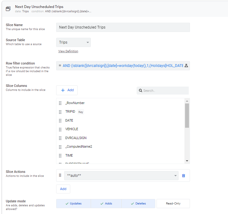

Can you post your whole slice formula?
AND (ISNOTBLANK([DVRCALLSIGN]),[date]=workday(today(),1,(Holidays[HOL_DATE])), [FUNDINGSOURCE]<>โ€œCANCELLEDโ€)
I changed it to:
AND (ISNOTBLANK([DVRCALLSIGN]),[date]=workday(today(),2,(Holidays[HOL_DATE])), [FUNDINGSOURCE]<>โ€œCANCELLEDโ€)
When I run the bot, the data is still from the 8th.
If Change the slice to
AND (ISNOTBLANK([DVRCALLSIGN]), [date]=(today()+1), [FUNDINGSOURCE]<>โ€œCANCELLEDโ€)
The data on the form is still from the 8th, but the data in my UX is from the 9th.

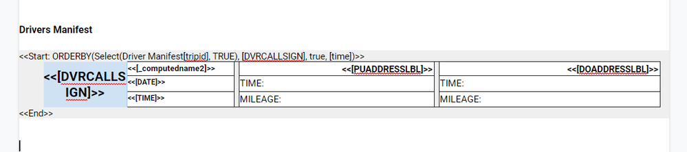

It looks like youโ€™re generating the file via a template. Why donโ€™t you just reference the appropriate records/slice in the template. What do you have in your template? Is your schedule Event โ€œfor each row in tableโ€, or not?
My template is pretty simple, I think.

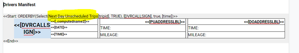

and BAM! Just like that, I found what I was doing wrong.
My Template has a select() function - and it was referencing the WRONG table (Driver Manifest in this case).
So my error is rooted in my noobness.
I did not understand that when I reference the โ€˜templateโ€™ in my processes, tasks, bots, etc. that the template is not automatically linked by the system. I had to manually associate the template to the right table.
