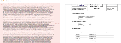

Sir Phil/Sir Steve, thank you for the advise and found an error on my app. Mind if I ask what is this error? I have attached the snip of the error (left side) and my doc template (right side).

New process 2' task 'New Task' Body template. Template variable '<html> <head> <meta content="text/html; charset=UTF-8" http-equiv="content-type" /> <style type="text/css">ol.lst-kix_rz0g7fe24up-2.start{counter-reset:lst-ctn-kix_rz0g7fe24up-2 0}.lst-kix_rz0g7fe24up-6>li{counter-increment:lst-ctn-kix_rz0g7fe24up-6}ol.lst-kix_rz0g7fe24up-7.start{counter-reset:lst-ctn-kix_rz0g7fe24up-7 0}.lst-kix_rz0g7fe24up-3>li{counter-increment:lst-ctn-kix_rz0g7fe24up-3}.lst-kix_rz0g7fe24up-0>li{counter-increment:lst-ctn-kix_rz0g7fe24up-0}ol.lst-kix_rz0g7fe24up-5.start{counter-reset:lst-ctn-kix_rz0g7fe24up-5 0}.lst-kix_rz0g7fe24up-1>li:before{content:"" counter(lst-ctn-kix_rz0g7fe24up-1,lower-latin) ". "}.lst-kix_rz0g7fe24up-0>li:before{content:"" counter(lst-ctn-kix_rz0g7fe24up-0,upper-latin) ". "}ol.lst-kix_rz0g7fe24up-0.start{counter-reset:lst-ctn-kix_rz0g7fe24up-0 0}ol.lst-kix_rz0g7fe24up-6{list-style-type:none}ol.lst-kix_rz0g7fe24up-5{list-style-type:none}ol.lst-kix_rz0g7fe24up-4{list-style-type:none}ol.lst-kix_rz0g7fe24up-3{list-style-type:none}ol.lst-kix_rz0g7fe24up-3.start{counter-reset:lst-ctn-kix_rz0g7fe24up-3 0}ol.lst-kix_rz0g7fe24up-2{list-style-type:none}ol.lst-kix_rz0g7fe24up-1{list-style-type:none}ol.lst-kix_rz0g7fe24up-0{list-style-type:none}.lst-kix_rz0g7fe24up-2>li{counter-increment:lst-ctn-kix_rz0g7fe24up-2}ol.lst-kix_rz0g7fe24up-8.start{counter-reset:lst-ctn-kix_rz0g7fe24up-8 0}.lst-kix_rz0g7fe24up-5>li{counter-increment:lst-ctn-kix_rz0g7fe24up-5}.lst-kix_rz0g7fe24up-2>li:before{content:"" counter(lst-ctn-kix_rz0g7fe24up-2,lower-roman) ". "}.lst-kix_rz0g7fe24up-3>li:before{content:"" counter(lst-ctn-kix_rz0g7fe24up-3,decimal) ". "}ol.lst-kix_rz0g7fe24up-8{list-style-type:none}ol.lst-kix_rz0g7fe24up-7{list-style-type:none}.lst-kix_rz0g7fe24up-8>li{counter-increment:lst-ctn-kix_rz0g7fe24up-8}.lst-kix_rz0g7fe24up-1>li{counter-increment:lst-ctn-kix_rz0g7fe24up-1}.lst-kix_rz0g7fe24up-4>li:before{content:"" counter(lst-ctn-kix_rz0g7fe24up-4,lower-latin) ". "}.lst-kix_rz0g7fe24up-7>li{counter-increment:lst-ctn-kix_rz0g7fe24up-7}ol.lst-kix_rz0g7fe24up-6.start{counter-reset:lst-ctn-kix_rz0g7fe24up-6 0}.lst-kix_rz0g7fe24up-5>li:before{content:"" counter(lst-ctn-kix_rz0g7fe24up-5,lower-roman) ". "}.lst-kix_rz0g7fe24up-8>li:before{content:"" counter(lst-ctn-kix_rz0g7fe24up-8,lower-roman) ". "}ol.lst-kix_rz0g7fe24up-1.start{counter-reset:lst-ctn-kix_rz0g7fe24up-1 0}ol.lst-kix_rz0g7fe24up-4.start{counter-reset:lst-ctn-kix_rz0g7fe24up-4 0}.lst-kix_rz0g7fe24up-6>li:before{content:"" counter(lst-ctn-kix_rz0g7fe24up-6,decimal) ". "}.lst-kix_rz0g7fe24up-4>li{counter-increment:lst-ctn-kix_rz0g7fe24up-4}.lst-kix_rz0g7fe24up-7>li:before{content:"" counter(lst-ctn-kix_rz0g7fe24up-7,lower-latin) ". "}ol{margin:0;padding:0}table td,table th{padding:0}.c18{border-right-style:solid;padding:5pt 5pt 5pt 5pt;border-bottom-color:#000000;border-top-width:1pt;border-right-width:1pt;border-left-color:#000000;vertical-align:middle;border-right-color:#000000;border-left-width:1pt;border-top-style:solid;border-left-style:solid;border-bottom-width:1pt;width:118.5pt;border-top-color:#000000;border-bottom-style:solid}.c2{border-right-style:solid;padding:5pt 5pt 5pt 5pt;border-bottom-color:#000000;border-top-width:1pt;border-right-width:1pt;border-left-color:#000000;vertical-align:top;border-right-color:#000000;border-left-width:1pt;border-top-style:solid;border-left-style:solid;border-bottom-width:1pt;width:156pt;border-top-color:#000000;border-bottom-style:solid}.c20{border-right-style:solid;padding:5pt 5pt 5pt 5pt;border-bottom-color:#000000;border-top-width:1pt;border-right-width:1pt;border-left-color:#000000;vertical-align:top;border-right-color:#000000;border-left-width:1pt;border-top-style:solid;border-left-style:solid;border-bottom-width:1pt;width:171pt;border-top-color:#000000;border-bottom-style:solid}.c9{border-right-style:solid;padding:5pt 5pt 5pt 5pt;border-bottom-color:#000000;border-top-width:1pt;border-right-width:1pt;border-left-color:#000000;vertical-align:middle;border-right-color:#000000;border-left-width:1pt;border-top-style:solid;border-left-style:solid;border-bottom-width:1pt;width:214.5pt;border-top-color:#000000;border-bottom-style:solid}.c16{border-right-style:solid;padding:5pt 5pt 5pt 5pt;border-bottom-color:#000000;border-top-width:1pt;border-right-width:1pt;border-left-color:#000000;vertical-align:middle;border-right-color:#000000;border-left-width:1pt;border-top-style:solid;border-left-style:solid;border-bottom-width:1pt;width:171pt;border-top-color:#000000;border-bottom-style:solid}.c0{margin-left:36pt;padding-top:0pt;padding-bottom:0pt;line-height:1.15;orphans:2;widows:2;text-align:left;height:11pt}.c6{padding-top:0pt;padding-bottom:0pt;line-height:1.15;orphans:2;widows:2;text-align:left;height:11pt}.c1{color:#000000;font-weight:400;text-decoration:none;vertical-align:baseline;font-size:11pt;font-family:"Arial";font-style:normal}.c22{color:#000000;font-weight:700;text-decoration:none;vertical-align:...

check your Test Equipment Details. <<>> it mean error.

Thank you all. This problem is now solved. What I did is I filled up the empty cells (table) and remove <<>> text..
