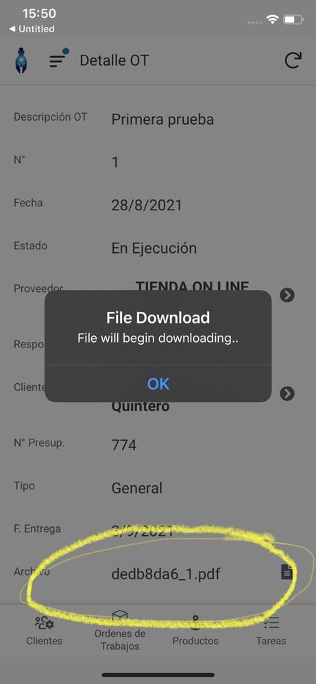

I am struggling with a problem that I cannot understand. I have created an app that generates a PDF report of work orders, it works quite well, or rather it worked quite well until yesterday, since it does not allow me to see the PDF files generated via workflow.
I have made several apps that generate PDF files that can be perfectly visualized both on mobile phones and on desktop PCs, that is, I have proven that it works very well regardless of the device or platform that the users use.
The problem now: on mobile devices, it does not allow me to โ€œviewโ€ the PDF files and forces me to โ€œdownloadโ€ them on my mobile or tablet. Is this normal?
The PDF file is generated correctly!!!, it is saved at destination folder and can be viewed ONLY from the desktop app.

I have the smiliar problem.
After this message, I click โ€œOKโ€. Then the pdf is opened but can not take any actionโ€ฆ I can not share, I can not print and can not close the view and return to Appsheet.
I must close Appsheet app and open it againโ€ฆ
This is the only thing I can click (It means โ€œOKโ€) but no response
