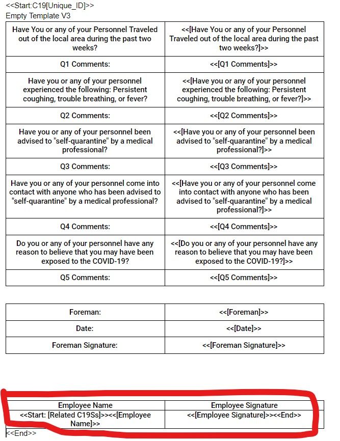

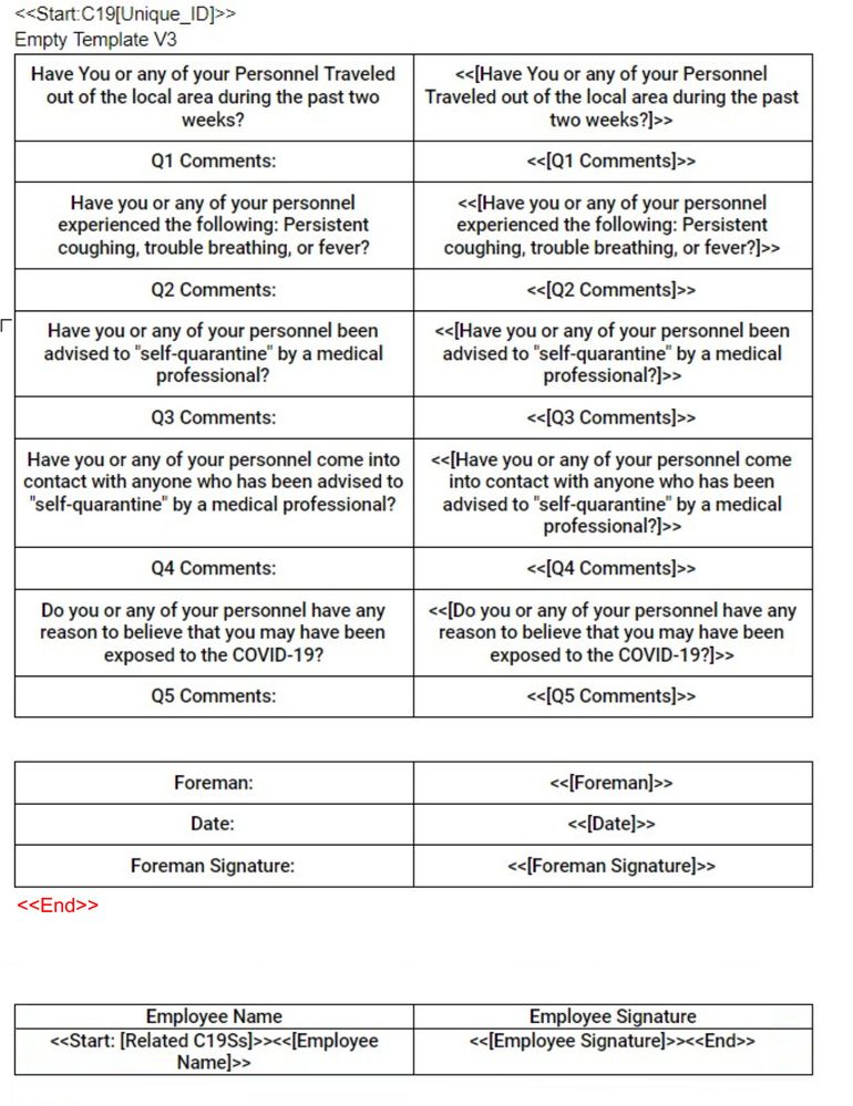

Can you post a screenshot from your PDF template? Provided you haven’t specified any template variables in between the <<Start>> and <<End>> it’s so normal that you don’t receive anything. Also please post a screenshot from your worfklow setup. Thnx.
Alright, I stripped my template down and slowly added stuff back in to see what was causing the issue. Now the
  • The Start and end functions work. (The workflow emails to me.)
  • With different Start and end functions, the whole template works.
  • It stops working when I make a reference. (see photo. Red shows the problem area)

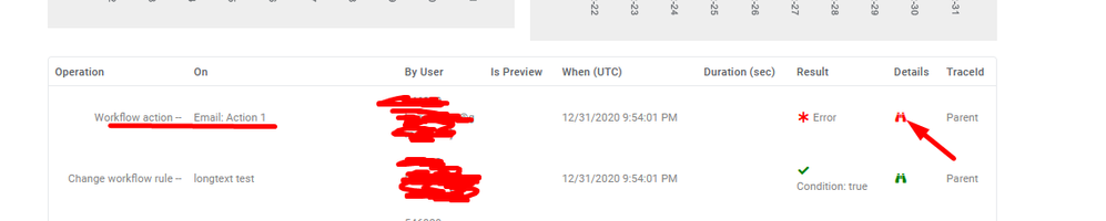

  • I now get the following error on the log:
    Error:
    “Jeenee.DataTypes.SpreadsheetException: The remote server returned an error: (400) Bad Request. → The HTML to PDF conversion web service failed to convert the HTML document to PDF for application ‘PaulusApp-770529 (f59e0b87-e262-4bdc-8856-3f003dbd1dc9)’ despite 3 retries due to: The remote server returned an error: (400) Bad Request. —> System.Net.WebException: The remote server returned an error: (400) Bad Request.\r\n at System.Net.WebClient.UploadValues(Uri address, String method, NameValueCollection data)\r\n at Nirvana.Data.PDFEncoder.EncodePdfRocket(Context context, String input, PageOrientationEnum pageOrientation, PageSizeEnum pageSize, Int32 pageHeight, Int32 pageWidth)\r\n — End of inner exception stack trace —\r\n at Nirvana.Data.PDFEncoder.EncodePdfRocket(Context context, String input, PageOrientationEnum pageOrientation, PageSizeEnum pageSize, Int32 pageHeight, Int32 pageWidth)\r\n at Nirvana.Data.PDFEncoder.Encode(Context context, String input, PageOrientationEnum pageOrientation, PageSizeEnum pageSize, Int32 pageHeight, Int32 pageWidth)\r\n at Nirvana.Data.WorkflowActionResultEmail.<>c__DisplayClass68_0.b__0()”

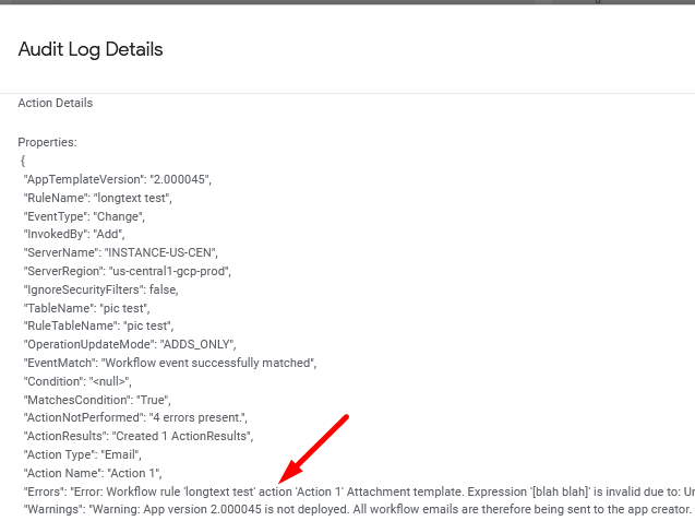

But regardless, that error doesn’t tell us much. There should be an error somewhere else that’ll actually say what the issue it. Like:
“Errors”: “Error: Workflow rule ‘longtext test’ action ‘Action 1’ Attachment template. Expression ‘[blah blah]’ is invalid due to: Unable to find column ‘blah blah’. Error: Workflow rule ‘longtext test’ action ‘Action 1’ Attachment template. Start expression ‘[blah blah]’ should generate a List of Ref values. Please verify that it generates a List and that the contents of the List are Ref values. Ref values should come from the ‘Key’ column of the referenced table. Error: Workflow rule ‘longtext test’ action ‘Action 1’ Body template. Expression ‘[blah blah]’ is invalid due to: Unable to find column ‘blah blah’. Error: Workflow rule ‘longtext test’ action ‘Action 1’ Body template. Start expression ‘[blah blah]’ should generate a List of Ref values. Please verify that it generates a List and that the contents of the List are Ref values. Ref values should come from the ‘Key’ column of the referenced table.”,
Which I got from here:
You can also try to use the “Test” button on the workflow, then “Send” on one record from the following screen, and if there is any error in the template it should show a pop-up with the error.
