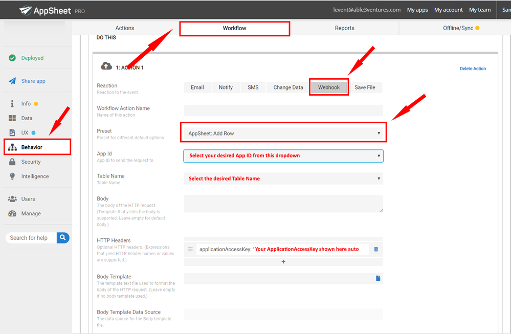

This might be a workaround to achieve this. But you need to set a REF type ENUMLIST column for the site addresses, where the agent can select multiple site addresses. Then you can create a webhook workflow rule
where you need to construct a JSON body with the integration of a <<Start: >><<End>> expresson similar to this:
which will create a row for each selected site address in that ENUMLIST column
