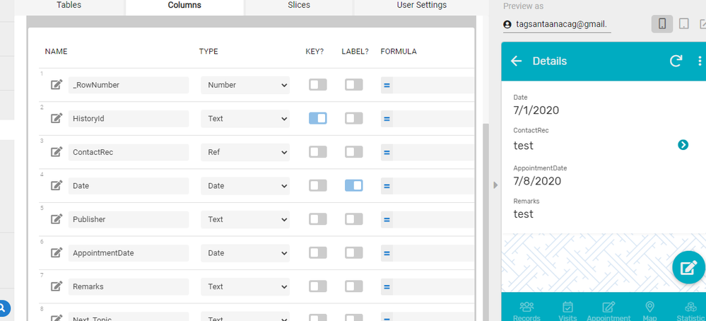

So this is my table A where I am getting my date from, it is a ref from Table B

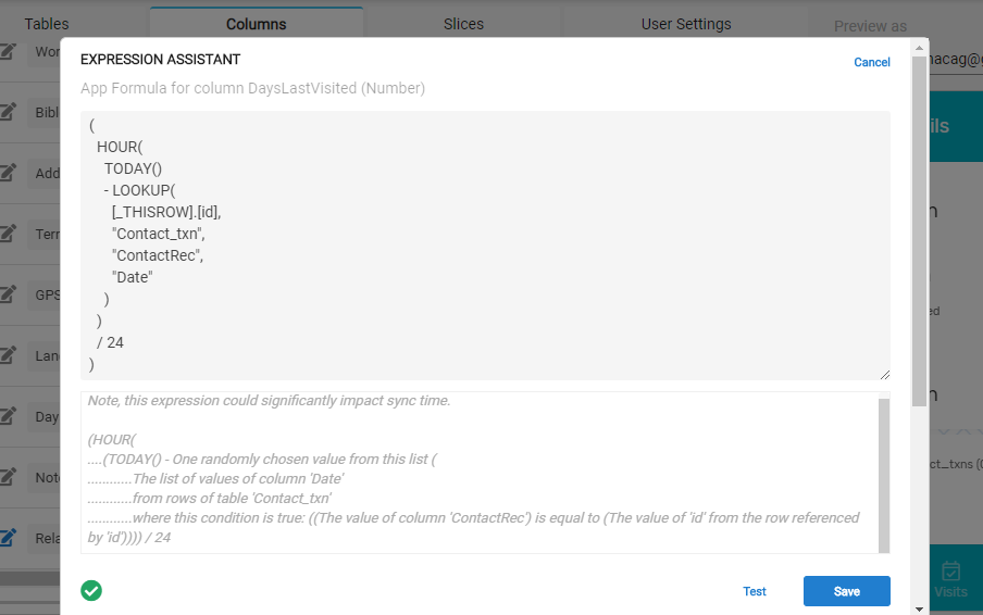

Please post a screenshot of the expression youโ€™re trying currently.
sure:
id my unique identifier from Table B
Contact_txn name of Table A
ContactRec my ref on Table A to Table B
Date is the column Iโ€™m copying
Also just so you know what I am trying to do, this date updates constantly .
I would suggest creating a temporary virtual column for testing. For the App formula expression of this testing virtual column, enter just the LOOKUP(...) part of the expression above. The use the Test button in Expression Assistant to test the expression to see if you get the expected results.

yeah, definitely not getting anything back.
Iโ€™m missing something but I feel like Iโ€™ve tried everything.
Does the value of the id column in table B occur in the ContactRec column of the Contact_txn table?
no, I donโ€™t think so. So on Table B, I have this column named Related Contact_txns with this formula REF_ROWS(โ€œContact_txnโ€, โ€œContactRecโ€) so I was assuming thatโ€™s my ref.
