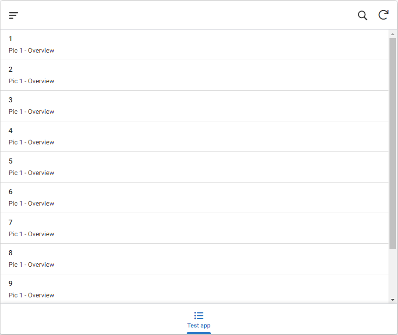

This is the main page of the app, where the user can select the relevant location they want to take pictures for.

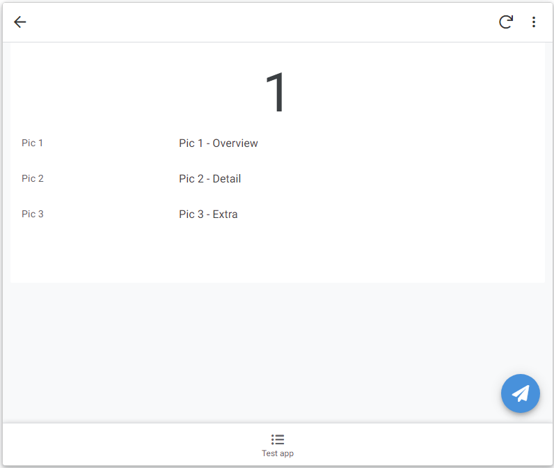

This is the detail view of the main page, with some general information, and a button that takes them to the picture guidance.

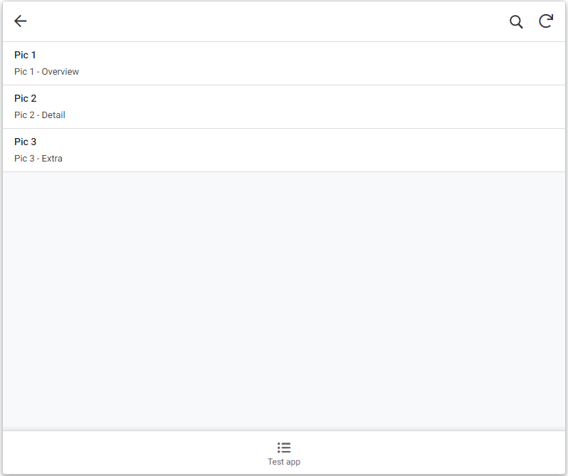

Overview of the different pictures to be taken for each location. This is a view from sheet2
