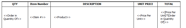

How do I have a list of all items on an email template. I figured out how to create an email template and some of the formulas (probably a longer formula than needed but none the less it works.) Currently when testing the email, I will get 10 emails with different products on each one instead of getting one email with all products.
I would like to have (1) email with all products instead of (10).
EX. I am ordering products from a vendor. They carry (10) products we need. I would like to have (1) email showing (on a purchase order template(all ready done)) instead of have (10) different emails.

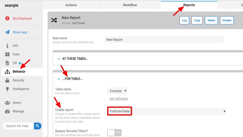

Have you used scheduled report instead of Workflow? If you have used an option “ForEachRowInTable”, yes it will send email for every record. You are probably looking Workflow insted of Report. If you want to add more records from a table, you need to use Start: & End formulas for that purpose. Please check this article.
I am using scheduled report instead of work workflow. I read somewhere on one of the blogs or watched a video saying that was the better way. I still thank you for the suggestion. (I just checked to make to sure I was using reports not workflow.)

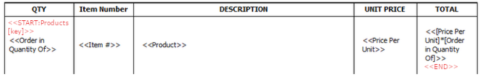

First of all, would I need that expression in every column I would want a list in?
Second, I used and expression <<Start:Products[Restock Needed]>> and the log says “should generate a List of Ref values. Please verify that it generates a List and that the contents of the List are Ref values. Ref values should come from the ‘Key’ column of the referenced table.” The only key column I have is ComputedKey and no Ref columns.

As @Aleksi mentioned, make sure your report is configured ForEntireTable:
No.
You would probably also find these informative:

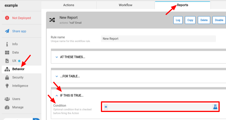

Throws an invalid Condition Error and the app crashes.
I should have mentioned it was for a slice.
I have “Slices” made up per vendor to only “email” certain vendors for there products.
Please post a screenshot.
Sorry working with (2) Screens
What is the Condition expression for the report?

[Current Stock]<=[Restock Level]

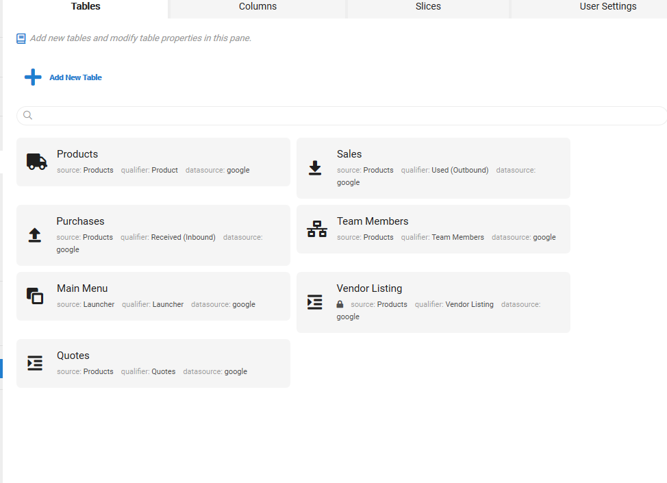

Can you provide screenshots of your tables?

I had meant for you to post more than that one screenshot, show us the column structure of your tables in question, describe how they connect, even some example records.
If you want to display more than one record in a workflow, you need to use a START expression, as the help file that I linked describes.
Let’s say you want to send the info for all Products in one mail, you’d add something like this to your template:
Judging by your list of tables, it is possible that you’re missing a linking table. I’m guessing you’re building either a Quote or Purchase record out of some number of Products, let’s go with Quote for now. This is a many-to-many relationship, as you can use the same products for many different Quote records. Setup a table called Quote Items, with at least 3 columns, a key, a ref to a quote (with isPartOf), and a ref to a product. Probably columns to copy over the price & item# data from the Product record as well (google “Appsheet dereference”). Then you’ll have a virtual column in your Quote table called “Related Quote Items”. Replace the START expression from the above screenshot with "<<START:[Related Quote Items]>>
