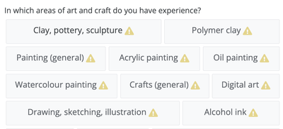

I tried using suggested values as some other posts have mentioned which gives me buttons. They are upset buttons though, with an exclamation mark in a yellow triangle
Solved my own problemโ€”I think this is one of those things that is very hard to search for because it's so basic no one thinks to write about it if they know it. My initial values formula referenced the label column instead of the key.
You think to yourself "Well I want it to show words so I'll link to the words", but that's a mistake. As an EnumList with the type of Ref the text is just a facade over what's really there, which frankly I should have realised when I added the options manually via the database. If you do that and look at the values it's gibberish that I assume is the unique ID from each added ref row. Therefore you want the suggested values to be generating a complete list of said gibberish AKA Row IDs or keys, which is very easy. Just select the key column from the referenced table in the expression assistant.
