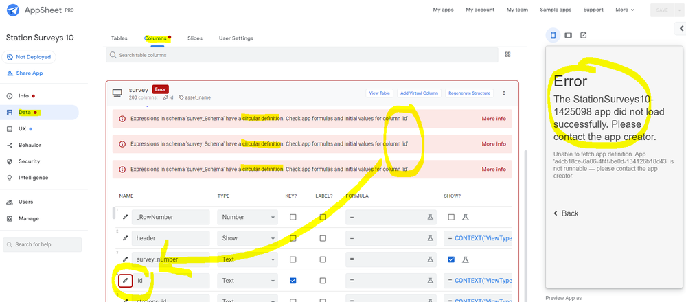

I woke up to an app that wouldn’t load this morning because 3 circular definitions were found in the ID column after 2 Automatic Consistency Checks ran overnight.
I haven’t done anything to or made changes to the ID column for ages.
I restored a good version (1.000058), Automatic Consistency Check ran and the new version (1.000063) failed again.
I restored another earlier good version (1.000057), Automatic Consistency Check ran and the new version (1.000066) failed again.
In the last few days I have been working on an email workflow with a PDF attachment who’s start expression (and other template expressions) obviously references the ID column…?
Is anyone else experiencing odd behaviour here…?
I’m obviously stuck now and can’t get any work done and any troubleshooting tips would be appreciated.
Many thanks.
Circular Definition Errors
ID Column
1 = Version error after overnight Automatic Consistency Check
2 = Failed restore from good version
3 = Another failed restore from good version
0 6 315
