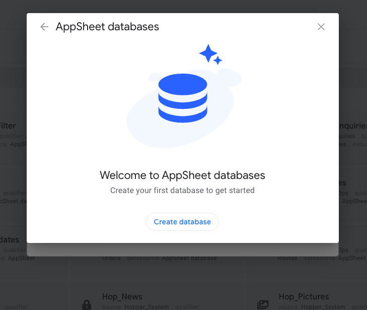

This fix isn't working for me as of this morning.  When I try to reconnect to my databases, AppSheet doesn't see them. This is so beyond frustrating.

Update: the fix mentioned above isn't working today either.  When I try to reconnect my database, AppSheet doesn't even seen them.
I am still seeing this issue, but not for all users, which is strange.
Same here. Anything that is based off of an AppSheet Database does not show. You can navigate to the database using the "DATA SOURCE" button, but the app itself does not see it.
