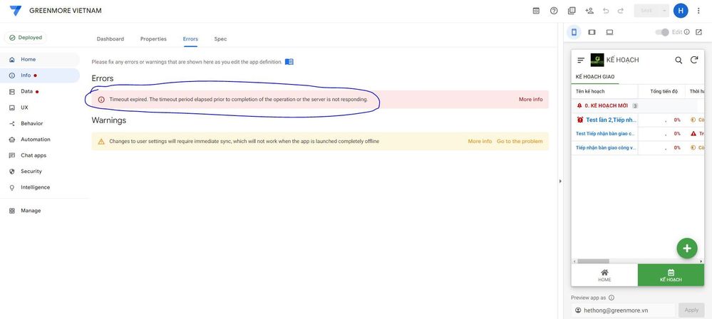

Error unable to edit appsheet
My Appsheet is currently having an error: "Timeout expired. The timeout period elapsed prior to completion of the operation or the server is not responding."
Right now I can't edit or change anything about it.
Does anyone have a way to help me fix this?
I tried every possible way but it didn't work

What data source are you using with your app?
I am using data source (Database): Google sheets
Are you able to open that gSheet just fine? Does it show a gray progress bar on the upper right corner when opening?
I still opened that file normally, and saw a blue progress bar appear, but only for about 5 seconds and then it disappeared.

You anticipated it wrongly ๐Ÿ™‚ Your data size is not big yet.
(31 tables * 50 rows  + 4 tables * 5000 rows) * 15 columns = 325.000 cells.
If your column amount is about that size, I guessed (average), this is not the reason. I have built much bigger apps with gSheet where some of the tables had 30..40k rows with lot of columns and more tables than you have, and the sync time has been 15..20 secs.. and without any security filter. When the app/data gets too big, syncing takes more and more time and then finally, it throws a timeout error because the app was not able to read the data or calculations with the virtual columns took too much time.
To build a big app with lot of tables and columns and lot of data, the solution is quite often to use real databases because then you can filter the data when the data is fetched from the database. But before that, you need to understand your app what you can filter away so the data would be as light as possible because you are using the app with the mobile devices. This doesn't mean that you can't use that filtered data, you just need to request it when it's really needed.
When using spreadsheets as a data source, the challenge is that when you sync the data, the app needs to fetch all tabs with all data from the spreadsheet. Google Sheet has it's own limits (10.000.000 cells), but the practical limit is somewhere 800.000 - 1.000.000 cells. Though you can use security filters with the app, but the filtering is happening in AppSheet server, not in Google Sheets.

I haven't seen this kind of behavior earlier.. so difficult to say what's the reason. If it's a bug, there is nothing you can fix. If there is something wrong with your gSheet, you could make a copy of it and then reassign tables one by one. The problem is.. you don't know is that the reason until you have reassigned them all.. maybe.
