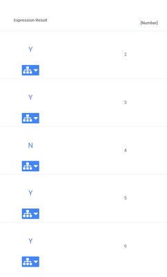

This expression is working fine on the Test tab but when I use it as a security filter a don't see any value (like if it was all FALSE).
Test before savingTest after saving, when the security filter is ON.
I've just changed the punctuation and it's working fine (add space before and after the split coma) :
IN([Name]; SPLIT(User_Slice[View acces]; " , "))
