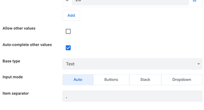

### EnumList and Enum columns have the same configuration๏ผš
- searchable & editable, plus
