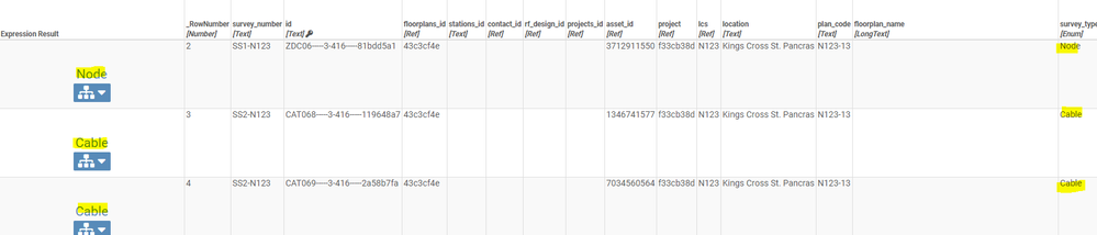

Testing [FindMaxRow] VC in the Expression Assistant yields the correct result and shows max row 2 for โ€œnodeโ€ and max row 12 for โ€œcableโ€
I then apply it as an Initial Value like this in the [survey_type] column:
LOOKUP([_THISROW].[FINDMAXROW],"survey","_ROWNUMBER","survey_type")
Testing [survey_type] Initial Value in the Expression Assistant yields the correct result and shows โ€œnodeโ€ and โ€œcableโ€ in the right places

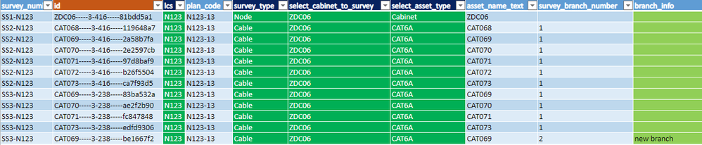

Hereโ€™s the survey table if it helps:
