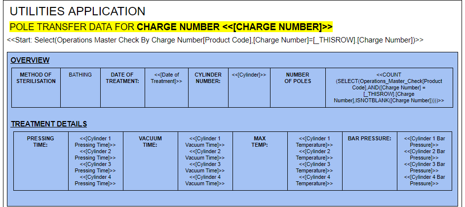

I have a workflow template that I really need help to format in a certain way but can’t get the expressions correct.
So the SELECT expression in the template extracts each row for [Product Code] which is the key value. With my current expression the template is being replicated for each product code but there are duplicate values associated with a [Product Code] that I only want to extract once. e.g. of my dataset
ROW1=[Product Code 1]=A1234, [Retention]=145, [Charge Number]=41795
ROW2=[Product Code 2]=B1234, [Retention]=145, [Charge Number]=41795
ROW1=[Product Code 3]=C1234, [Retention]=145, [Charge Number]=41795
There could be 50 different [Product Codes] associated with the same [Charge Number] and [Retention] value (among others).
When I generate the template I would like to display the [Charge Number] and [Retention] values etc… once and the list of associated [Product Code]'s with that [Charge Number]/[Retention] etc…

The template itself is being generated from a Search Form where the user enters a [Date] and the expression in the template matches ALL [Charge Number]'s that have that corresponding date so my template will contain multiple different charge numbers which is fine but I would like to present them as per above in order of Charge Number.
I have attached an image of my template file and a working example hoping that might explain my request a little better.

Hi @Suvrutt_Gurjar
I have attached the Top and Bottom half of my template. Hope this is ok.
Hi @MauriceWhelan,
Thank you.
For the expression at the bottom of the report can you please write an expression like
<<Start:[Related Operations_Master_Checks] >>
instead of
<<Start:Select(Operations Master Check By Charge NumberRelated Operations_Master_Checks] >>
