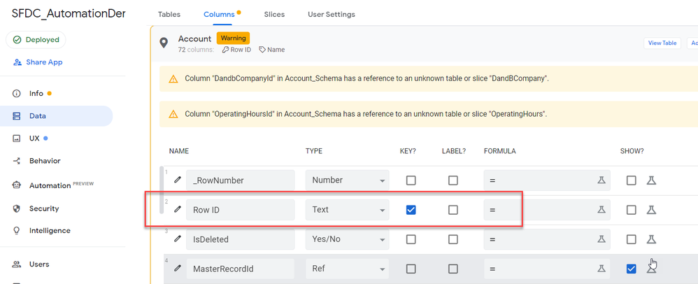

I’m looking into integrating with Salseforce.
What I want to do is to create a Salesforce record from AppSheet. I haven’t found a way to achieve this so far, but if anyone knows how to handle this, please let me know.
Here’s what I’ve tested
When Salesforce is specified as the data source, the Row ID is specified as the key item.
When I specify Salesforce as the data source, the Row ID is specified as the key item. This indicates the SalesforceID, and I understand it so far.
However, my understanding is that the SalesforceID is issued when a record is saved on Salesforce.
However, since it is a key and required field in AppSheet, the SalesforceID is required when creating a new record.
So I’m wondering if it’s possible to create a record manually from the AppSheet.
I hope someone knows how to create a Salesforce record and can help me out.

Why not just populate the Row ID with UNQIUEID()? This way there’s a value - does salesforce throw an error?

From my Salesforce development experience, I believe that Row ID is not necessary when creating a Salesforce record.
However, since Row ID is required in AppSheet, I’m not able to send POST request from standard screen.

Using UNQIUEID(), I was able to create the record!
It was my failure to do some basic validation.‍♂
I hope this will be a knowledge to the community, so I’ll excuse myself a bit, but I’ll share the background that led to this post
Salesforce gives an 18 digit SalesforceID for every record.
https://help.salesforce.com/articleView?id=000324087&type=1&mode=1
This SalesforceID format is different from AppSheet’s UNIQUEID format, so in my mind, UNIQUEID is meaningless.
This time, I was able to confirm that I could get the 18-digit SalesforceID in the end even with AppSheet UNIQUEID.
It was a good experience for me to know that the behavior of Expression changes depending on the data source.
