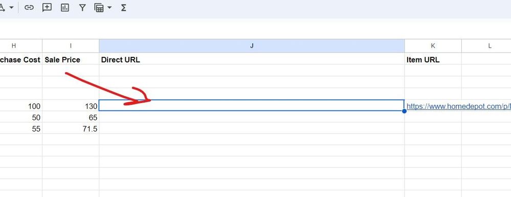

I am trying to figure out how to get appsheet to automatically generate a URL for the detailed view of a specific row in a table and then post that URL into a column on the same row.
If I navigate in the app editor to a specific item in this case as I am using the inventory app template, the editor generates a link to that specific detailed view. Screenshot 2024-05-27 233048.jpg
I can manually paste it into the spreadsheet and it works perfectly and takes me straight to the detailed view of that item.
How do I get appsheet to do this? Seems like a simple task but apparently not an easy one. I have poured over the manual through deep links, etc. and I cant get anything to show up in that column no matter what expression I use, let alone a URL. I read over this post since it seemed somewhat close to what I am trying to do, but I was unable to make any sense of it: https://www.googlecloudcommunity.com/gc/Tips-Tricks/META-POST-Deep-Links-URL-Parameters/m-p/349632
I am looking to do this since I can use the spreadsheet to print labels with a description and QR code generated by the labeler from the URL (The labeler can take in a CSV and automatically print the whole dataset while simultaneously converting specific column(s) in that data set into a QR code) to attach to each product bin to quickly access the details page for each product to quickly to audit inventory and order more stock.
Thank you.

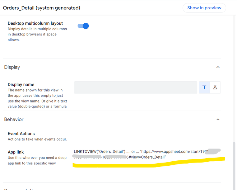

If understanding of your requirement is correct, please try an expression as follows in the URL type column's app formula setting
CONCATENATE("https://www.appsheet.com/start/190db37f-7f30-4175-b10f-19270495b156#view=Orders_Detail","&row=", [Key column of table])
You will get the bold part in highlighted in blue of the above concatenate expression in the detail view as highlighted in yellow below
Please concatenate it with &row=", [Key column of table]
as I have shown in the concatenate expression above.
You can probably use LINKTOROW().
