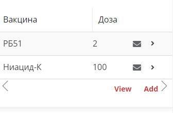

But this data shows me like a text, I want to see this is a table, and I want to press an open his detail.
How can I do that ?)
This Is result:
I want to like this. Like a realated table
