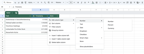

Is it completely irrelevant which data type you set in gsheets because you have to set a data type in appsheet anyway?
There are far fewer data types in gsheets than in appsheet.
See screenshot.
