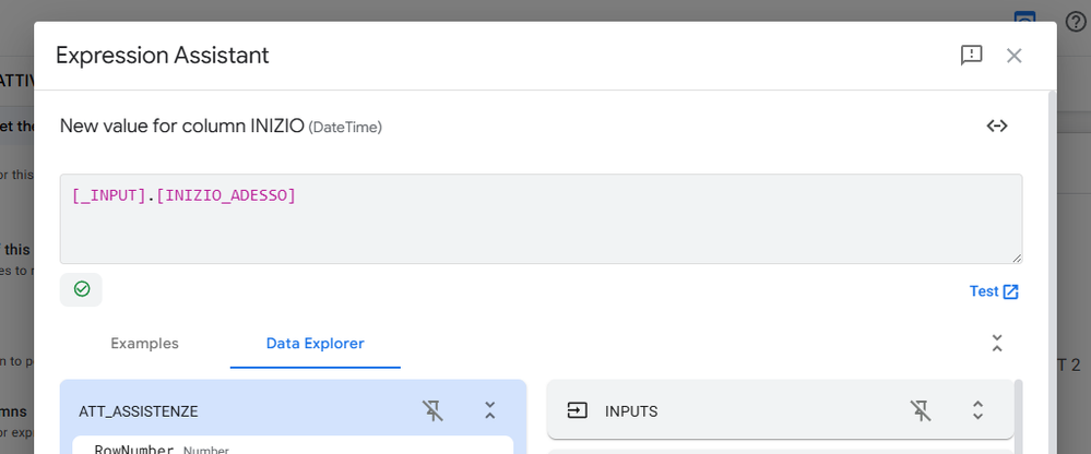

I set up an action "COMPLETA ATTIVITA" that takes advantage of the new INPUT function. Unfortunately it seems that formulas using DateTime fields don't work correctly.
For example in this simulation I should set:
[INIZIO] = current time - 1 hour
[FINE] = current time
Instead, it seems to keep the values โ€‹โ€‹of the fields already filled in previously. Can someone help me? Is this a known behavior or am I doing something wrong?
this is the configuration:

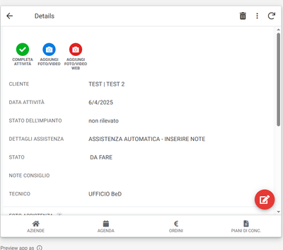

And this is the behavior: INIZIO DateTime field is not changed (always 06/04/2025)
Has anyone had the same problem? Thanks to anyone who will try to help me
"Data Attivita" looks like a Date column - not a DateTime column.  Are you sure you are comparing to the correct field?
sorry i was imprecise. I am interested in getting a Date value as the final goal.
What you see is a virtual column that transforms the DateTime value into Date.
