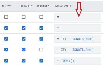

Have you put the expressions in INTITIAL VALUE?
Put here to display on forms.Put here to display on forms.
