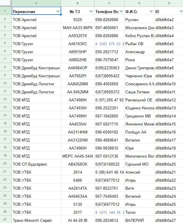

I ran into a problem that I still cannot solve.
Perhaps this topic was already there, but unfortunately I did not find it.
I have a table with which I can transfer the necessary rows using: add new row in another table, in the next table I need to select the value of the 3rd table from the other table, for now I used the simple formula - UNIQUE(Перевозчики[Перевозчик]) , then I need to select data, with the next column, with a list of data only based on the data in the previous column, the list is filtered from the previous column.
Then, I will transfer the completed data to the next table, through add new row in another table.
0 4 337
