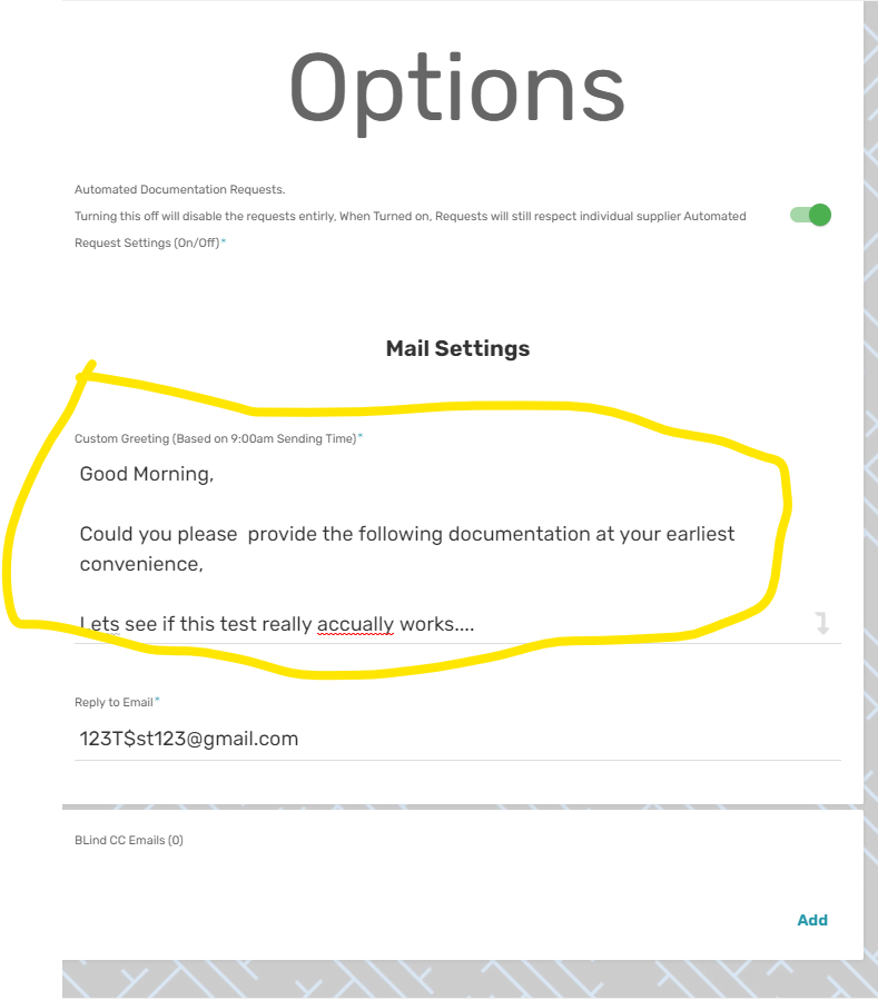

I have a report in which the user can set some custom text, greetings, signitures etc,
What seems to be happening is the line breaks that the user has entered in are not being carried over to the report. The output is in 1 long string.

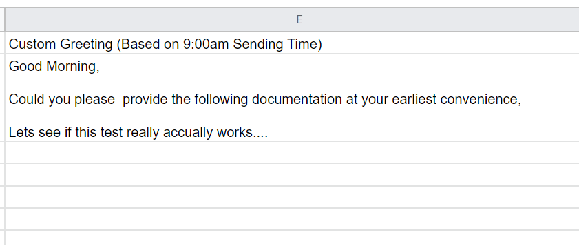

User Email Settings in the App. Column Type (Long Text)
Spreadsheet Cell. Appsheet places into Cell Correctly

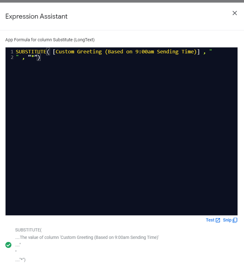

Alternatively, make a new column in Settings table to substitute all newlines with some special character. Then in the template substitute it back.
SUBSTITUTE( [custom greetingโ€ฆ] , "
" , โ€œ*โ€)
<<SUBSTITUE(Any(Settings[new column]) , โ€œ*โ€ , "

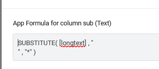

Formula in Template
<<SUBSTITUTE(Any(Settings[Substitute]) , โ€œ*โ€ , "
Formula in Table

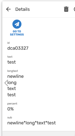

I just tried both of my suggestions, and both of them worked. Are you sure the longtext column itself isnโ€™t blank?
Output:
Template (workflow run on a different table):
[sub] expression:
record:

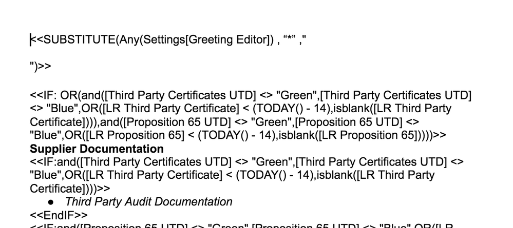

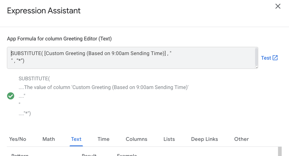

So I have It setup just like you, It is replacing the new lines with the asterisk. It is also Taking the asterisk back out in the reportโ€ฆ but it is not creating a new line. For some reason,
<<SUBSTITUTE(Any(Settings[new column]) , โ€œ*โ€ , "
The formula above Does not cause it to create a new line. Everything is working as you described except when the report is created and sent it does remove the asterisk but for some reason everything just goes back to 1 line.
Is there Something else I can replace the * with to force a new line?
I realized that template expressions in the workflowโ€™s โ€œemail bodyโ€ field are parsed differently than when they are in an external template document, so I moved both expressions to an external document, and set it for both email body and attachment template. Only the START expression method worked here, NOT the double-substitute, so try that one instead.
