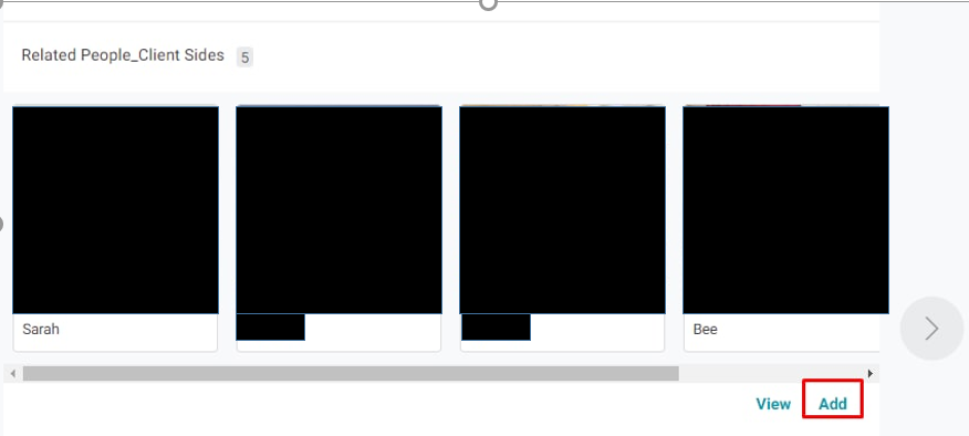

I mean below table โ€œPotential Clientโ€ , and โ€œClientโ€ have inline view of People related to โ€œPotential Clientโ€ , and โ€œClientโ€
so when you press โ€œaddโ€ people there will have a form, already ref to โ€œPotential Clientโ€ or โ€œClientโ€, If that below โ€œPotential Clientโ€ , then I dont have to choose for โ€œClient IDโ€ in the dropdown again.
Slice is a good idea, can I do a different view for a โ€œClientโ€ slice than the table โ€œPotential Clientโ€ ?
Thatโ€™s, I would say, one of the main advantage of it
About the Add: if the slice is read-only, you will not have the Add button (you may preferrently set the update mode to โ€œupdateโ€)
