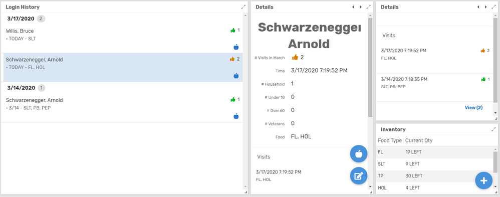

Th bottom view is actually an inline view. You can tell because it has the โ€œView(2)โ€ text at the bottom.

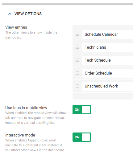

The Dashboard should be set to interactive. Did you turn on the property?
Yes, I made sure that was on

Here is my Table #2 (the login table). This works for now, but I donโ€™t like the look of the details view in the top right.

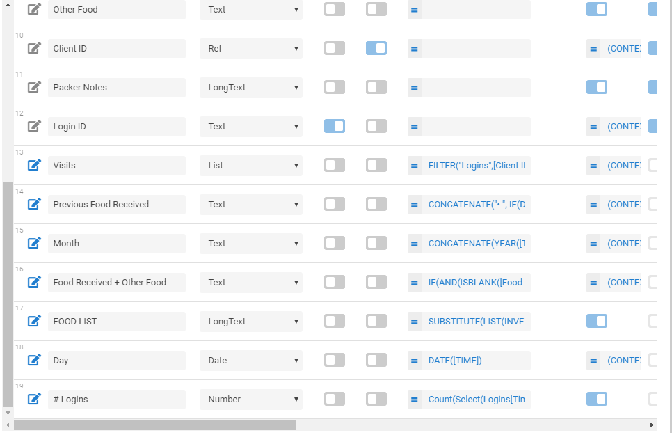

And here are some of the columns from that table that might be useful: The Column #13 (Visits) is the column Iโ€™m currently using solely for that top right view.
