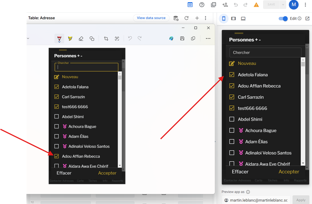

One related thing that puzzled me...
Let's say I add a Person. Even after all the required updates have been done in the spreadsheet, the selector frequently does not update and requires a full sync (like Chrome page refresh) to show the updated list. Any idea?
Are there sheet-side formulas running that make updates to the data that impacts how the dropdown gets organized?
No. The only thing is a script in a second Google sheet running an importrange() every 5 min.
