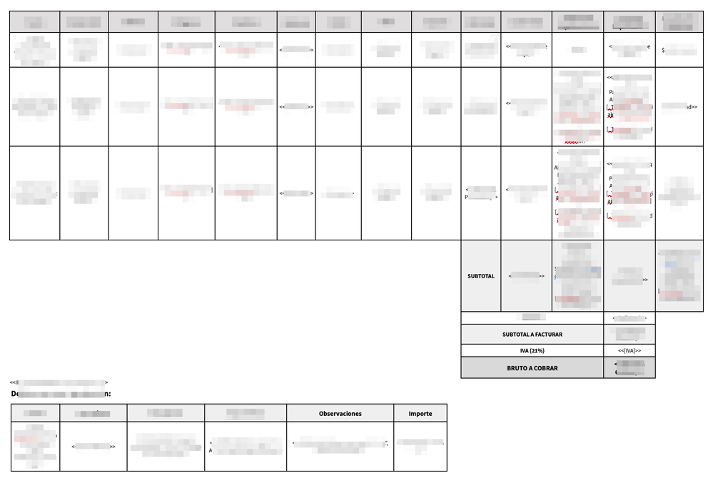

PDF generator update brakes the PDF output
AppSheet actually uses the Skia/PDF m111 to generate PDF.
Sometimes when they update the PDF generator, our PDF files will be broken: Wrong pagination, wrong text size, ... > The output looks bad and unprofessional.
In some cases, AppSheet is able to fix this. In other cases there is no fix. We need to update all our templates 😳
Here is the story of what I was aware (and affected) of:
  • Feb 2021
    Update from Qt 4.8.6 to Qt 4.8.7.
    Change in the font size and column width.
    No fix from AppSheet. All Templates needed to be updated.
  • Mar 2021 Update from Qt 4.8.7 to Skia/PDF m88.
  • Dec 2021 Update from Skia/PDF m95 to Skia/PDF m96.
    Change in the row height.
    No fix from AppSheet. All Templates needed to be updated by reducing the line spacing.
  • Dec 2022 Update from Skia/PDF m107 to Skia/PDF m108.
    Change in the pagination.
    Fix from AppSheet 5 days later.
  • Mar 2023 Update from Skia/PDF m110 to Skia/PDF m111.
    Change in the text alignment in columns
    Fix from AppSheet more than 2 weeks later by reverting to the previous version Skia/PDF m110.
  • July 2023 Update from Skia/PDF m110 to Skia/PDF m114.
The goal is to find a way how we can prevent this in the future. Maybe by an announcement?

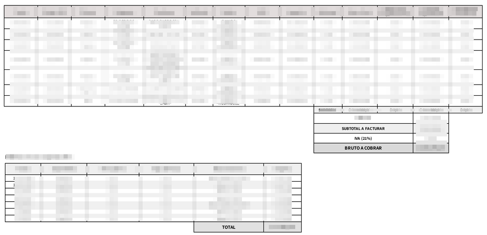

@Joseph_Seddik Do you use tables in your Google Docs templates? I think you see the change only when you have tables, because the cell height got a bit bigger.
@Fabian_Weller Yes I do. Here's an example:
And here's the result, the cells width are maintained and the hight changes and fits exactly the cell's content:
I can share with you the empty template if you'd like.
@Joseph_Seddik @jyothis_m OK I see. Maybe it's because of the fact I use a lot "Table in Table"? I mean I have a one-cell-table and inside this I have the "real" table. I use this method to control the formatting.
@Fabian_Weller The second small table at the bottom is actually a table within a single cell. But it is only one not "a lot", so maybe..
