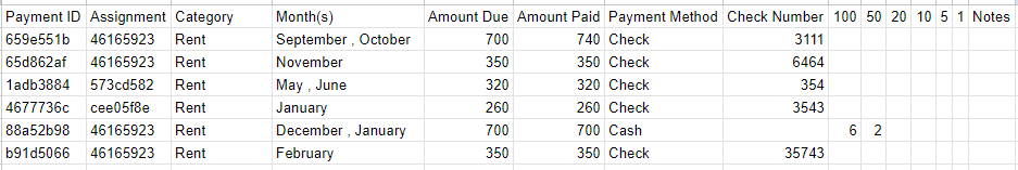

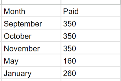

I have payment data that is collected where I can select multiple months if a tenant pays for multiple months at a time (see first image). I then have a table that splits up those payments into their individual months for a report that I need to create (see second image). The report looks like my third image where the pivot table makes it so I can show the names of the tenants and then the amount paid for each month. Each month will have it's own column and show the amount paid. I can't get the pivot table to actually show the amount paid.
Any ideas on how I can create a pdf report with the data looking like my third image? I don't know if it can just be done with the data in the second image and using formulas and stuff on the pdf template or if I need to split the data even further onto another table and then pull from that data in the template, or just something else entirely. There are times that data needs to be edited or deleted, so keep that in mind.

Ok, I am so so close to getting this to work. I realized that I needed to base the PDF template off of my Contracts table and then get the relevant child and grandchild records referenced to it.
Below is how I have the table set up, the data it is pulling from, and the results in the "September" column. It seems to be pulling all of the relevant info I need for the one tenant, but it is repeating 350 for the three entries for the same tenant. I am having a hard time setting up a filter() or select() function that works.
<<Start:[Related Alpha Lists]>><<select(Alpha List[Paid],[Month]=โ€Septemberโ€)>><<End>><<End>>
There is the function I came up with.
Thoughts?
Why is there a 2nd start expression? And why does your select expression not compare against the current tenant from the 1st start expression? Take another look at my original example.
