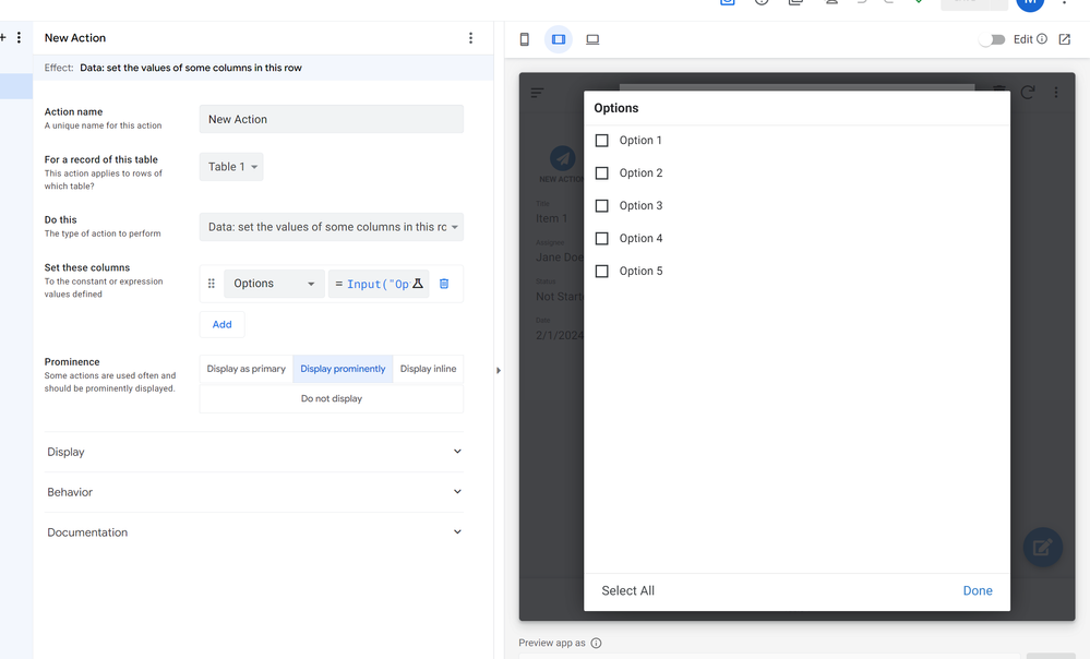

I made a dummy app to test, and adding Input("Options","") to an action worked as prescribed

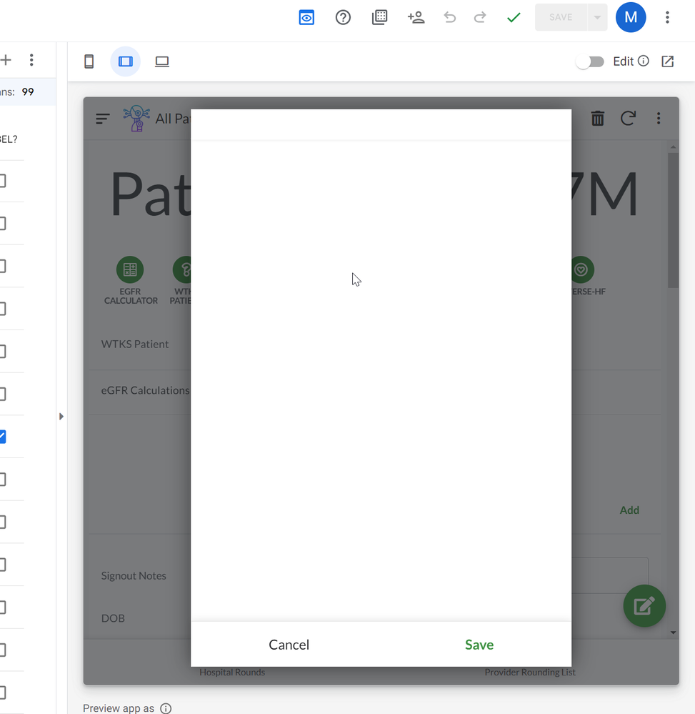

What's weird, though, is it did NOT work in my production app ๐Ÿค”

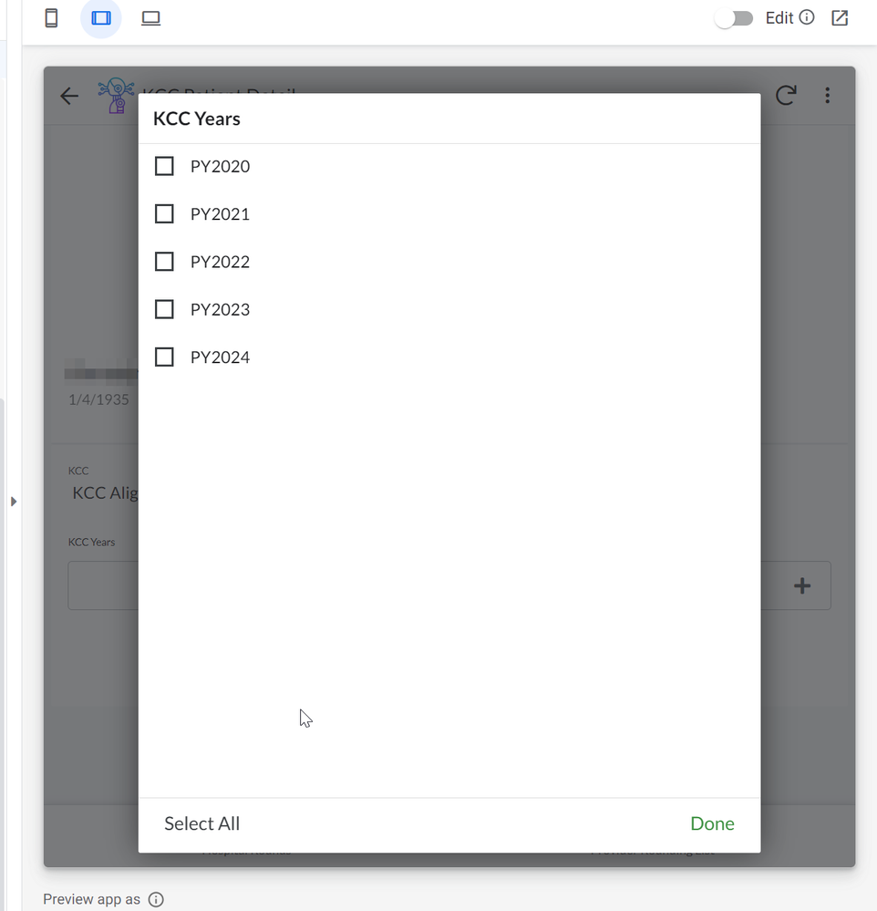

I created a test patient and a new action, and here's what i get:
The action is for the field KCC Years, and the action is to set the value of KCC Years to Input("KCC Years", "")
No clue what i might be doing wrong because it looks dang near the same as the previous one.

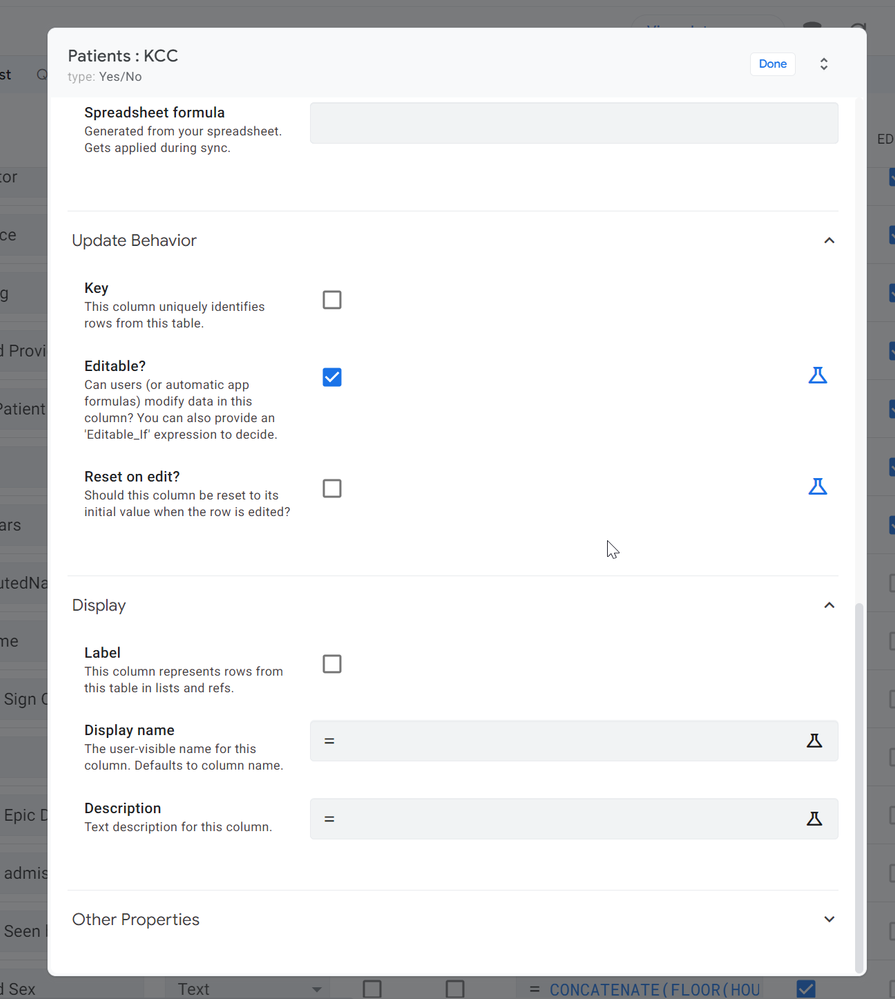

Do you have any condition on when that column is supposed to show or when it is editable?
Negative:
The column should always be visible and always be editable. The only condition i currently have is to control the visibility of the button to trigger the action based on a list of allowed Context("View") options
WAIT!!!!
I was wrong, the screenshots above are the wrong column.. The KCC Years column does indeed have a Show If condition, which is likely the culprit! I will investigate and report back
