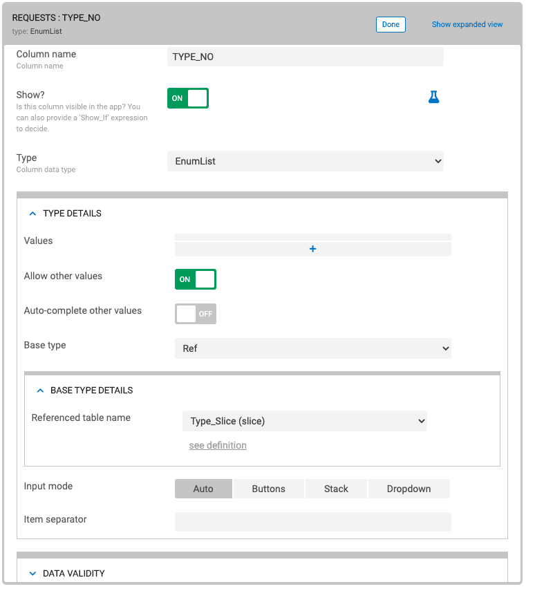

The TYPE_NO is not the key for this table. It is a reference to another table. So I want it to group by Type_Name to show the items together with the same Type. Sorry that wasnโ€™t clear.
Is it in fact a column of type Ref? The behavior you describe suggests it isnโ€™t.
So it is an EnumList with a base type of Ref.
Youโ€™re grouping on an EnumList? I doubt thatโ€™s supported.
It actually groups it just fine, whether there is one or more in the list. It just doesnโ€™t sort it by the first item in the list. Itโ€™s using the TYPE_NO (Key) to do the sorting of the group.
