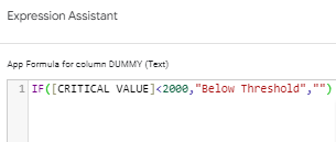

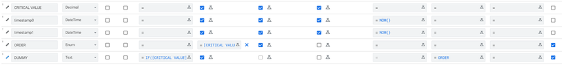

To make things easy for me I also added a column called CRITICAL VALUE which represents the threshold or critical value as I do not know how you determine so I just set a value of 2000. I then also created a DUMMY virtual column of type text.
Then I set ORDER to only show if the CRITICAL VALUE >=2000 and below this it will not show but the virtual column DUMMY will show instead.

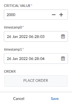

Here is the app display with critical value (CV) at 2000 so it allows one to place an order as it is reached the critical value to do so
Now if one goes below the CV the order column does not show and is replaced by the DUMMY virtual column of type text which if CV is less than 2000 shows "Below Threshold" a shown below
So below the CV the dummy menu is displayed and greater and equal allows an order to be placed.
Also if a user enters save below the CV no order is placed as shown below
If the amount is greater or equal to CV then entering saves places a valid order as shown below
So creating a dummy virtual column named DUMMY with a DISPLAY NAME of ORDER and using the CV to control which column is displayed allows what you require.
You can replace CV with a formula etc but I just used a CV column for this.

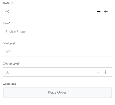

Dear gregdiana1
Thanks for your well explanation and example.
I am using the same formula.
IF([On Site] <= [Critical Level], "Place Order", "Looks good")
The problem is that i have 5 items needs to follow. Would like to place order if on site of any of them is less den critical level.
IDItemMin LevelOn SiteOrder ReqImageCritical Level
001Engine Straps10055 OPS/GBIE/OWL/ULD/big strap_image.JPG50
002AVI Straps5029 OPS/GBIE/OWL/ULD/AVI straps_image.JPG20
003ULD Tape_THRU34 OPS/GBIE/OWL/ULD/thru tape_image.JPG2
004Flight File Pouches10060 OPS/GBIE/OWL/ULD/cargo envelope_image.JPG50
005Pallet Stack Corner10090 OPS/GBIE/OWL/ULD/pallet stack corner_image.JPG50
The problem is not able to select "Place Order" automatically even On Site is less than Critical Level. See below.
Critical level is 50 on site is 40 but place order is not selected.

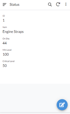

If it is blank the column will not show in the app as shown below
If one enters any text as shown below then it appears as you point out. This is not obvious to any user
When the row is blank even using an initial value does not work as shown below
However when on edits one gets
