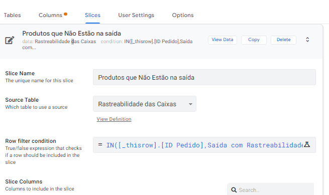

Hey Steve,
Actually, I’m trying to use two slices, as if I was building a “shopping cart”:
-One slice which “holds” the itens which are selected in the below slice;
with filter: IN([_thisrow].[ID Pedido],Saída com Rastreabilidade[Número do Pedido])
-one slice which selects only the ‘oldest’ [gtin] columns( or the first created ) >0 stock level, and which are not added in the above mentioned slice.
With filter: ([GTIN] = min( SELECT( RELAÇÃO DE TODOS OS PRODUTOS[gtin], AND(([saldo]>0), [GTIN] <>“1111111111111”, [GTIN] <>“2222222222222” ))))
It seems that the above filter is almost working as intended, but instead of showing the ‘oldest’ stock of each [gtin] higher than zero, it is showing all records equals to the last [gtin] with stock >0 .
Thank you for your support.
Regards;
Fábio

I’m afraid I’m getting confused. What is the Produtos Que não estão na saída table for?
Hey Steve, I’m sorry the absence.
This slice holds the products in the list which have not been dispatched yet.
nOT(IN([id pedido],SAÍDA COM RASTREABILIDADE[Número do Pedido]))
When user fills the form with child records, it hold the child records differentiating the ones in the form with all other records of child table.
I’m not sure if thats the ‘right’ way to do so.
