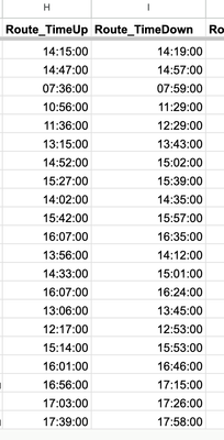

As for how the data is stored, here's a screenshot of my Gsheet :
As you can see it's stored well, the format of the cell is time too.
Anything else I could show you ?
