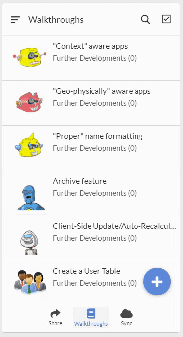

@Jonathan_S by multi-select, @Erik_Meyer means this little guy:
Q1
There isnโ€™t a way to turn that off - itโ€™s baked into the system. Could be a feature request, but honestly that little guy is really helpfullโ€ฆ and now that Iโ€™m remembering, I think that was a feature request that we bugged the devs about forever.

It doesnโ€™t show up for my Deck views. But those arenโ€™t for everyone and everything.
If I remember right, I think there was an explanation once something like this:
  • Itโ€™s a โ€œsmartโ€ control, and only shows up if and when thereโ€™s the capability of it being used. If there are no actions that can be run over all the rows being shown, the toggle wonโ€™t be shown.
Seems something like that. Even though the only action it shows on my other views is the Delete action, even making that unaccessible does not deactivate multi-select. However, if the data being viewed is not allowed to be edited by the user, it will turn off. So, use that info as you will.

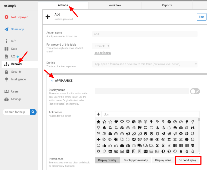

Edit the actions to be unavailable to users:
Did you explicitly remove actions from the slice?
Then you should inhibit their display:
Iโ€™ll repeat the answer youโ€™ve already been given: no.
Yes.
Thank you @Steve, that was what I needed!
The slice method started working as soon as I removed the auto option for slice actions.
The appearance setting of do not display for the individual actions also worked, without using the slice. As I had guessed, as soon as the actions were hidden, the multi-select that made them accessible also went away.
