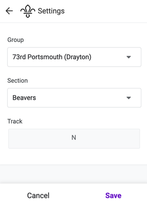

I am trying to define a Slice of my TRACK_ACTIVITIES table, using a value from USERSETTINGS(Track).
Nothing I do returns a slice with any content.  What (horribly obvious thing) have I overlooked?
The only thing I can think of - but don't know how to check - is that USERSETTINGS(Track) is a dependent lookup in the User Settings form (see image).  I think/hope the Track value returned in the UI Form, based on preceding choices of Group and Section, is saved into USERSETTINGS and not just recalculated in the UI?

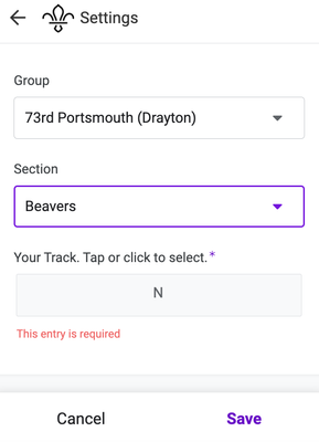

The dependant drop-downs, present the single correct Track (N in this case) - but the user must click it so it's selected and saved.  I can enforce this by making the field required - but that isn't very smooth for the user.

See the form below.  User has selected a group and a section, the dependent drop-down has automatically picked up 'N'.  However, the user must click the 'N' to select it.  This is the step I want to avoid.

Thank Marc.  I'd already tried that, and that only succeeds in forcing "This entry is required" and not selecting the [Track].

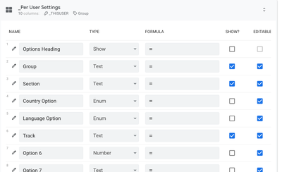

In User Settings, I am defining 3 fields as follows:
Group : valid if GROUPS[Group]
Section : valid if GROUPS[Section]
Track : Valid if GROUPS[Track]
As you no doubt know, Appsheet recognises the intent and treats these as dependent drop-downs on the form.  The result [Track] is always a single value.

FYI in this screenshot, user has just selected Section = Beavers. The App shows Track and the (only) available value "N".  To save the form, the user will need to click on the "N" option.
Oh, you're using implicit dependent dropdowns. That would make sense why it didn't work. You would have to write the appropriate SELECT() expression as if you were setting up manual dependent dropdowns, then use that as the "{valid_if expression}" in my previous suggestion.
