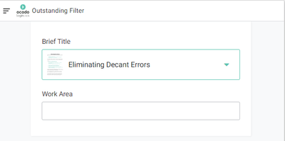

I have one table called 'Briefs List'
However this form is acting as a filter for another view.
It should be that you select the brief title from dropdown and it pulls through the list of zones applicable. I have tried as a virtual column, and proper column, but it's just not working.
shaneludlow_2-1698165472971.pngshaneludlow_3-1698165475981.pngshaneludlow_4-1698165482457.png
Originally had it setup as a detail view with title being quick edit, but that didn't change anything, so I thought I could to as a form, pull the work area list and in the filter just take the most recent line of change.
The column it should be pulling info from is
I am thinking because it's a EnumList that it's not working
Switched Work Area in this filter to be EnumList and still doesn't work

@shaneludlow wrote:
Column '_THISROW' is used in a SELECT or list dereference expression and should be a List/EnumList of Refs
If you do not use [_THISRROW].[Brief Title] in the LOOKUP expression, the system gets confused. Please read the trouble shoot section carefully.
If you want to retrieve an ENUMLIST, fine. It has nothing to do with what I have pointed out.
Try attaching [_THISROW] to the first argument of LOOKUP [Brief Title].
LOOKUP() Troubleshoot
The Zone(s) list in Briefs List table is an enum so they can pick multiple options, but I want to return whatever has been selected and saved once form submitted
Ahh I had [_THISROW][Brief Title] without the .
Works now!
