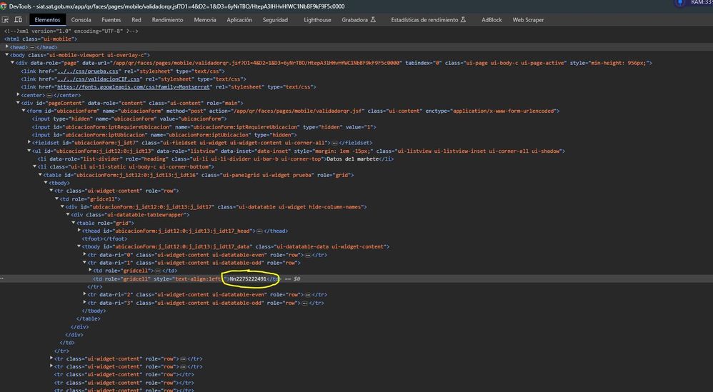

IMPORTXML() is a great formula in google sheets!! anyhow Im running out of aknowledge. I need to ge the yellow marked data, could you give me an ide of how to get it? thanks!!
You can click right and use copy full xpath to get the xpath to be used with xmlimport() in sheets
