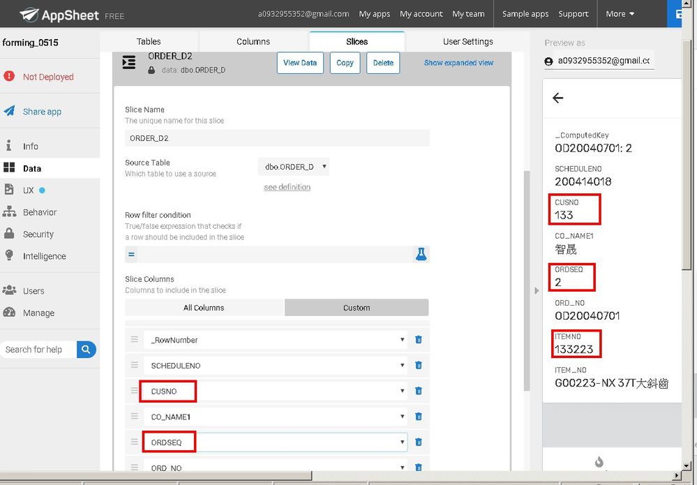

Source is โ€œms sql serverโ€
Directly connect to the database and then browse the database directly
, Where the red box is marked:
cusno: 133, the correct value should be: 0133
ordseq: 2, the correct should be: 02
itemno: 133223, the correct value should be: 0133223
Ask the teacher for help
Thank you
AppSheet does not modify Text values upon display, so I would have to assume the value being provided by your database also does not have the leading zero. Can you provide a screenshot of an SQL statement and output showing the stored values?

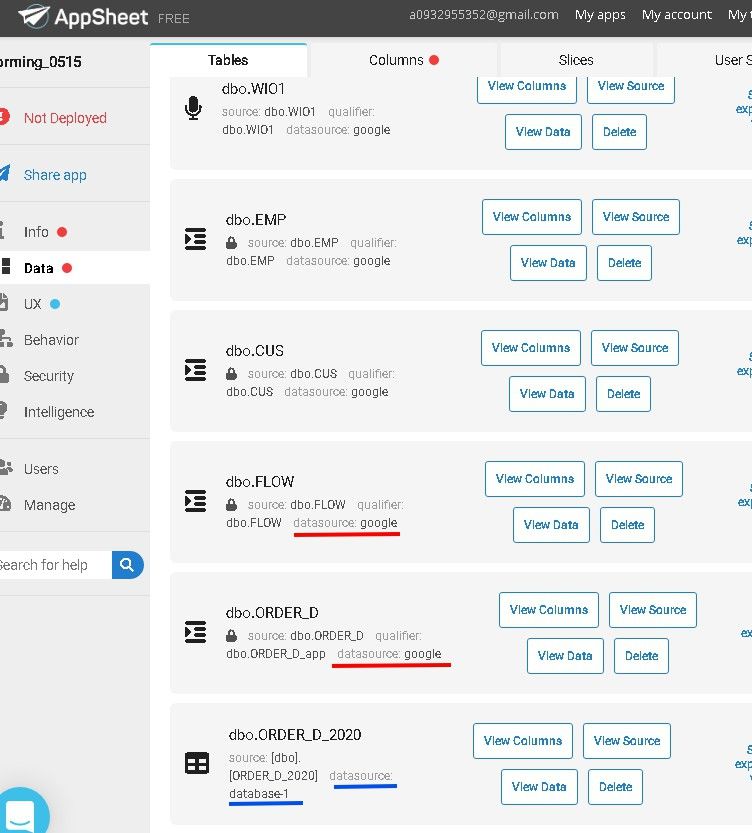

As shown in the red line of the attachment: datasource: google
And the blue line: database-1: google
I remember that when I first started, I was transferred from the specified โ€œms sql serverโ€ source?
I do nโ€™t know when it will become a datasource: google
Or did I accidentally press that setting there?
Is there any relevant documentation for this part of the operation?
Thank you
