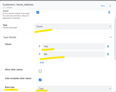

Could you mention what is the base type of the enum column or more importantly the other table's column where it is updating through action.
My testing did not show any problem in saving in backend as well as showing up in the email delivered  from automation, properly as Yes/No Values.
Email received from automation:
Backend data saved:
Column configuration:
The column  saved in another table through action:
In the other table also the column type is "enum" with "Yes", "No" enum options.

As @Suvrutt_Gurjar suggested. Please check the Base Type of the Enum column and make sure it is set to Text.
