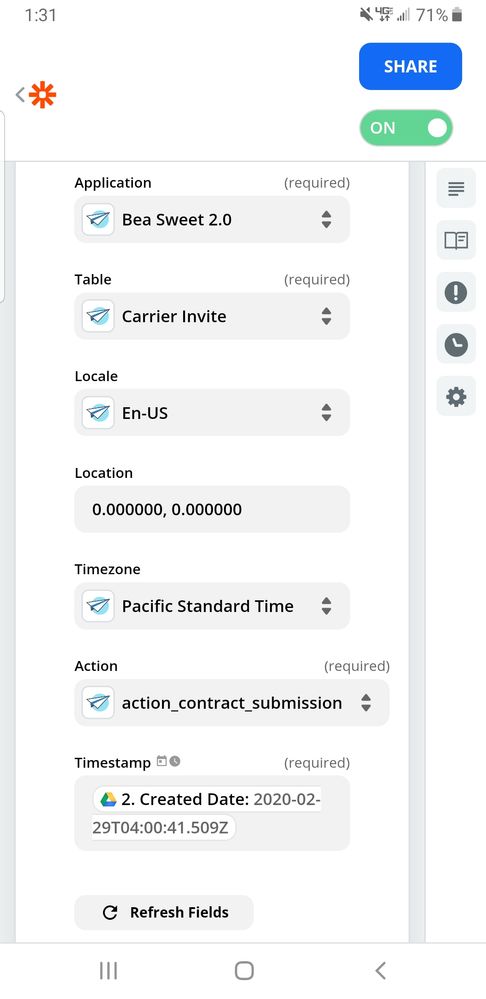

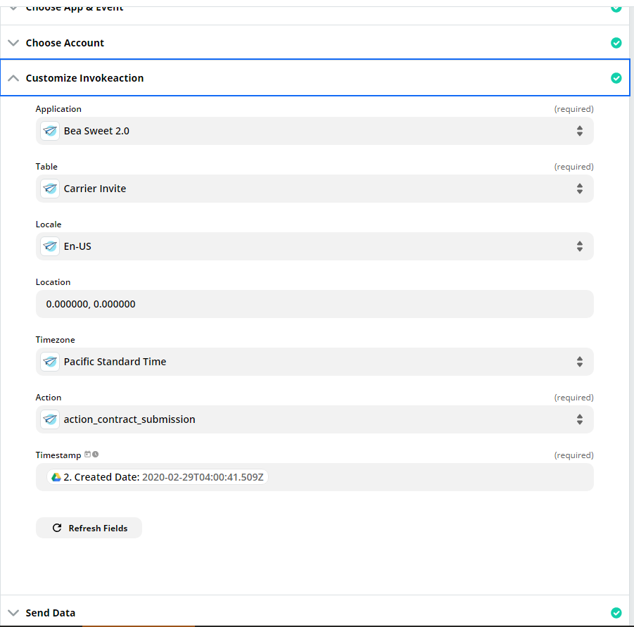

Here is the AppSheet action I have set within Zapier. Only thing I’m not too sure of is the Timestamp field, which probably indicates that is where the problem lies, but I am not sure.
Edit: Just realized the timezone is set to PST. I’m in EST. Not sure if that has anything to do with that action not being invoked, but I’ll correct it and see.

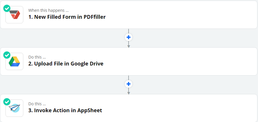

I’m almost certain that Zapier’s AppSheet step is not calling the AppSheet action in my app. Here are the 3 steps of my Zap. The first 2 work perfectly. The 3rd step, the AppSheet step, is not working correctly.
There are pretty detailed instructions for calling AppSheet from Zapier here:
It says in that article to use AppSheet 2.0.0 so I think that may be part of your problem. It looks like it’s trying to use that Timestamp field as a key value to find the right row in your table, but the “ErrorDescription” in your screen shot says there is no row in the table with that key value. Maybe with AppSheet 2.0.0 you can specify the key values rather than using a Timestamp like that. Does that help?

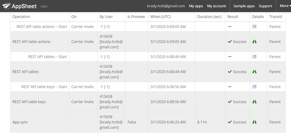

If you look in Audit History for the REST API request, it will show you the data values that are arriving at the server including the key values. See https://help.appsheet.com/en/articles/2247996-troubleshooting-api-calls
Thanks for that info, I checked the history and it looks like the REST API was successful:
However, the AppSheet action did not fire. I am assuming that means the error is on Zapier’s side, which again probably has something to do with the Timezone difference. I tried using Zapier’s Formatter and adjusting the [Timestamp] column +5 hours. When I went back and ran the test again, it adjusted the value of the Timestamp like it should, but then the red error box’s time adjusted with it, and ending up with no results. So i’m currently trying to wrap my head around what all that means, and what my next step for troubleshooting is.
One thing I just noticed, is that the time values in the Audit History are exactly 5 hours greater than my current time. So maybe it’s something on AppSheet’s side?
