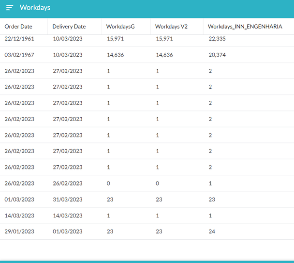

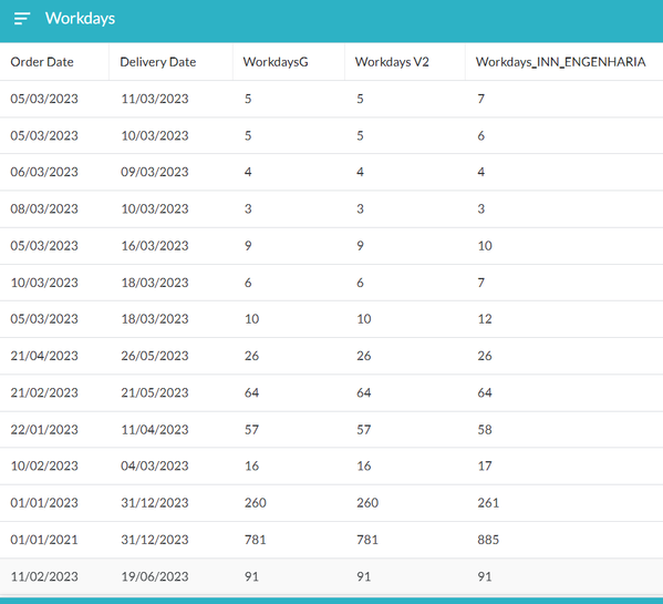

The test results are as follows -[WorkdaysG] is based on NETWORKDAYS() spreadsheet function in G sheet. [Workdays V2] is the expression I shared above and [Workdays_INN_ENGENHARIA] is based on the expression you shared with 53 weeks.
[Delivery Date] is equivalent to [End Date] and [Order Date] is equivalent to [Start Date]
Hope this helps.
