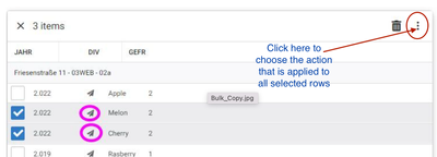

Yes, those icons on each row are row specific and will only copy the row they are listed on.  to perform the Bulk copy, you need to use the menu in the upper-right hand corner.  Selecting an action from that list will apply it to all of the selected rows.
hi WillowMobileSys - thank you for your prompt reply.
i tested it out, but there is no icon for "bulk-copy" in the menu in the upper-right corner - when i click on the menu there is only "delete-icon".

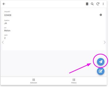

in the meantime, i think i understand the reason why:
action is called: "App: copy this row an edit the copy"
... copy this row + edit the copy ... >>> "edit" refers only to single row!
i also tested several options in menu-section "Appearance"
a) Display overlay
>>> bulk-copy-icon does not appear in table view >>> only in "detail view"
>>> "detail-view" refers to single row!
b) display prominently
>>> bulk-copy-icon does not appear in table view - only in detail view
c) display inline
>>> bulk-copy-icon appears next to each row because this action is only a single-row-action ...
d) do not display: this is for automation ...

The view in your original post doesn't appear to be the same.   In that image you were showing an Inline action - the icon you had circled.  If you were to return to that view and  attempt the "bulk action" again, select at least one row, and tap on the "3-dot" menu, you should see the ability to apply that inline action to ALL of the selected rows.
In order for an action to show in the "Bulk action" area , it must be a row level data action.  The "App: copy this row and edit the copy" action did not show up because it is actually a navigation action.  It opens a Form for a NEW row pre-populated with all the details of the row being copied. AppSheet does not allow these in the "Bulk Action" area
For clarity, every action operates on just a single row.  Those cases where there is a list of rows being sent to an action, is just a case where they are sent one-by-one sequentially.  When a row level data action is shown in the app, it will only operate on a single row so it can only be shown where the context of the view is a single row - like a Detail view.

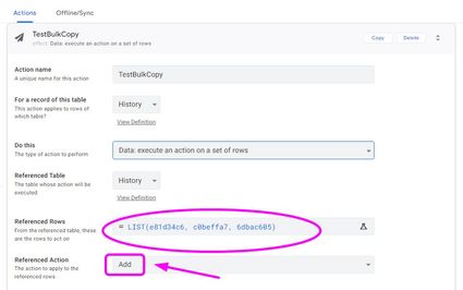

Is it correct that action with name: "Data: execute an action on a set of rows" is the action ("Bulk action") i need for my problem?
Step 1:
When i setup "Bulk Action" ("dublicating" some rows in the same table ...) i am asked for "referenced rows" - i don't want to pre-define the Bulk for copying here but i want to use "bulk-select" in the appsheet menu - but without input of "Referended Rows" i get error-message - i only can get it to work if i input some Ref-Keys for BulkCopy ...
how can i solve this problem?

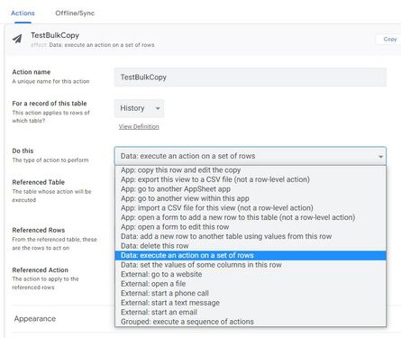

Step 2:
As a Referenced Action there is only "add" (no "copy" ...)

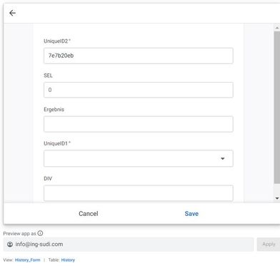

But after clicking on button i get a inpurt form to manuly input some values.
> after pressing "save" only this record is shown in the list of items ...
