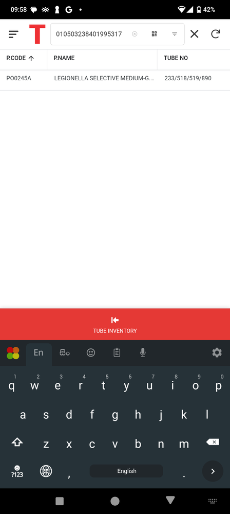

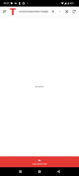

this is my interface
 when I scan my barcode to searching area ,it does not search because it has 33 digits, as below screen shot
after I removing last 15 digits , it can search as below,
Screenshot_20240421-095805.pngI think you can understand my problem and help me to sort out it,
thanks
