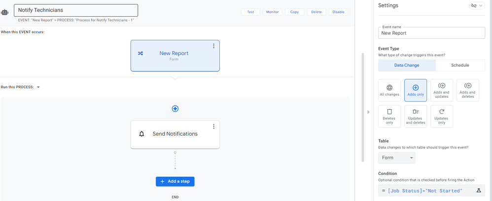

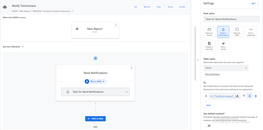

i have already enabled push notifications, using the firebase api. but when record is added on my public app i need to send a push notification to the user on my secure per user app.
How is the automation that sends the notification triggered?
the public app has an automation that when a record is added it sends a notification to the email referenced in the new record
What does the monitor tell you?
Monitor automation - AppSheet Help
all the statues say complete on the monitor. just to be sure we are on the same page the intention is to send a notification from the public app to the secure app. the automation is running on the public app
