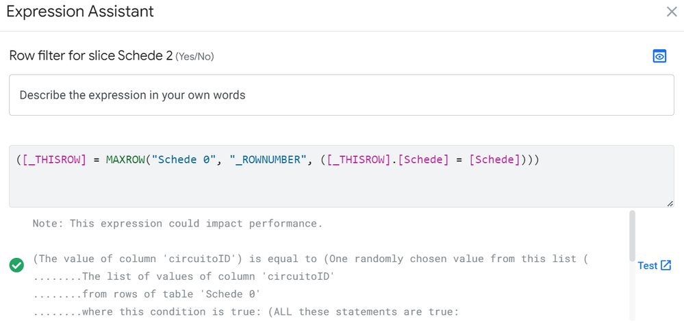

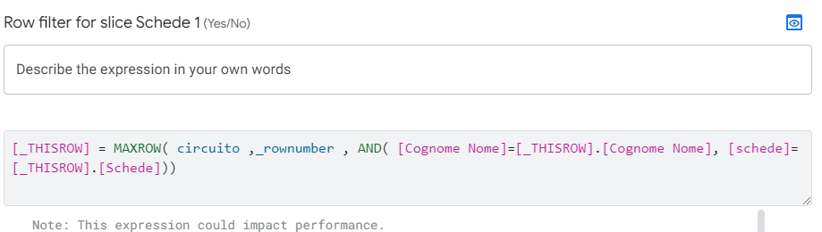

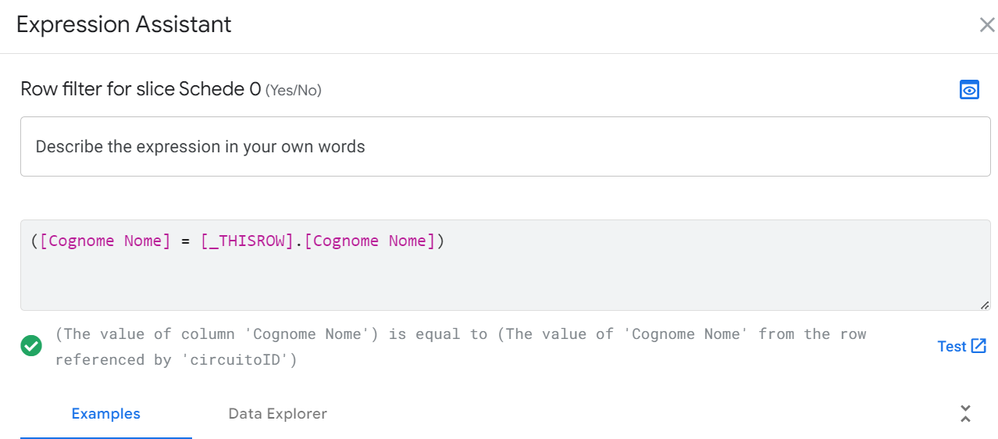

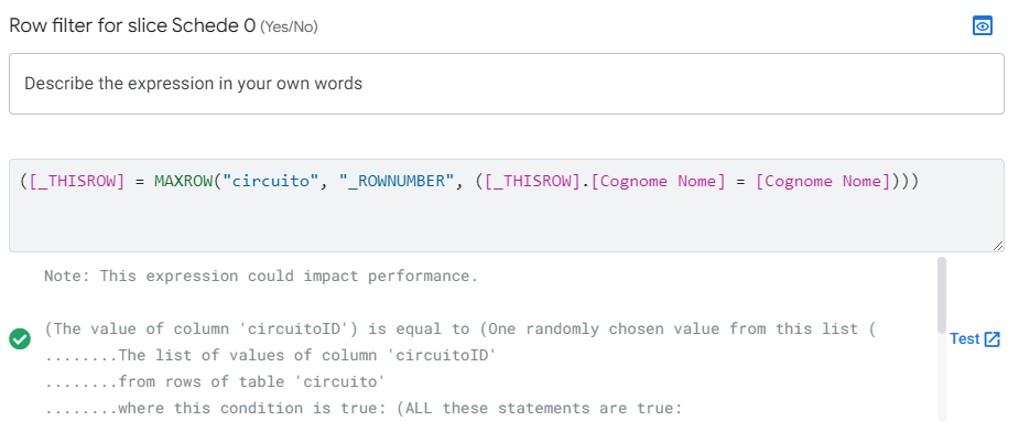

Another option to try. You already have the slice for unique [cognome nome] values. Create a second slice for unique combinations of [cognome nome] and [schede] together, with:
[_THISROW] = MAXROW( table , rownumber , AND( [cognome]=thisrow.cognome , [schede]=thisrow.schede))
Then set up your target view on that 2nd slice and use a much simpler LINKTOFILTEREDVIEW action that just matches the [cognome nome].

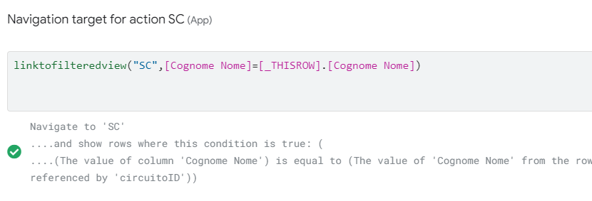

Instead with LINKTOFILTEREDVIEW() I tried this filter
LINKTOFILTEREDVIEW('SC', AND([Surname Name]=[_thisrow].[Surname Name] , [circuitoID]=maxrow("circuit", "_ROWNUMBER", AND([Surname Name]=[_thisrow].[Surname Name ] , [tabs]=[_thisrow-1].[Tabs] ) ) ) )
but besides being very slow it doesn't give me any results.. thanks in advance..

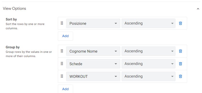

Have you tried simply using drill-down group-by in the view config?
Yes, it's the one I currently use, but it's not very customizable, with format rules. Is it possible that the filter on slices isn't working for me?

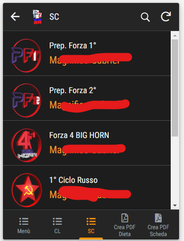

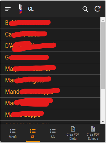

It works perfectly... thank you so much. My ignorance has no limits....I'll post images of the slices created and their views. THANK YOU SO MUCH AGAIN...
