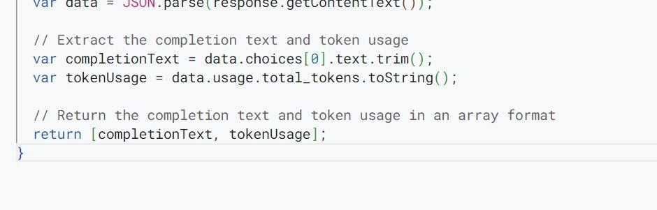

thank you this was helpful. Looking at your script it seems like the issue im facing i havent created a proper path to get the return values.
i dont how do i get this data.choices[0]....from my logs
Request successful. Response: {"success":true,"message":"E-Way Bill is generated successfully","result":{"ewayBillNo":571.........."ewayBillDate":"31/08/2023 11:12:00 AM","validUpto":"01/09/2023 11:59:00 PM","alert":""}}
This is the structure of the returned object from OpenAi API.  I know how to set up this stuff in the code because the documentation for the API tells me how things will be structured; from this I can then build the dot-notation necessary to extract the specific element I want.
https://platform.openai.com/docs/api-reference/chat/create
Your specifics return contents will depend on what your script is doing.
If you look at the object you provided, you'll likely want the "result" stuff
it worked! converted it tostring() and treated it as an array!!

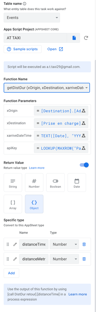

Types are good (number everywhere, from table to Script to automation result (I set it as object with corresponding keys and type set to number...
Have you configured those 2 return values in the call a script task?
Sure I did ๐Ÿ™‚
Both as "Number"
Documentation seems pretty straight forward, but damn, I've lost my day on this...
Maybe show screenshots of your full setup.
please show a screenshot of your bot's task that calls the Appscript Task
Yes sure !
Here it is :
That's my Apps Script call :
And the next step where I use the outputs to set values of a new row in another table (Courses) than the one (Events) that triggered the bot (might be something useful... )
And here is the Script itself :

Looks like you've mixed up your variable names. You use xDistanceTime in the script but then rename it to distanceTime in the task config return value. The latter is how you should refer to it later, with [call DistDur retour].[distanceTime] which is not what you said you tried.
Change the type of the returned values in your object to Decimal rather than Number?
