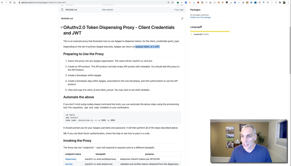

If you want to try this yourself, I've got a GitHub repository with all the sample code, and a README to guide you along.
And finally, a Youtube screencast where I walk through this same information.
