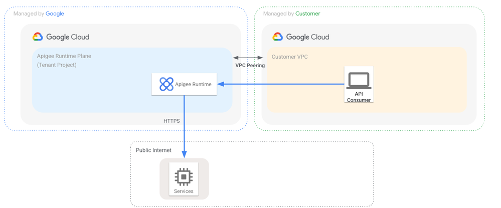

Apigee X with Default Internet Egress Configuration
By default an Apigee X runtime has unrestricted internet egress access. This means that even if you decide not to expose your API ingress endpoints publicly they can still talk to any publicly facing API on the internet within a service callout or use them as an API target endpoint
You can test the above by creating a new API proxy in your Apigee organization for https://mocktarget.apigee.net with the basepath /mock and deploying it to one of your environments.
When you call that proxy you should see a successful response like the following:
$ curl https://api.example.com/mock -I
HTTP/2 200
x-powered-by: Apigee
